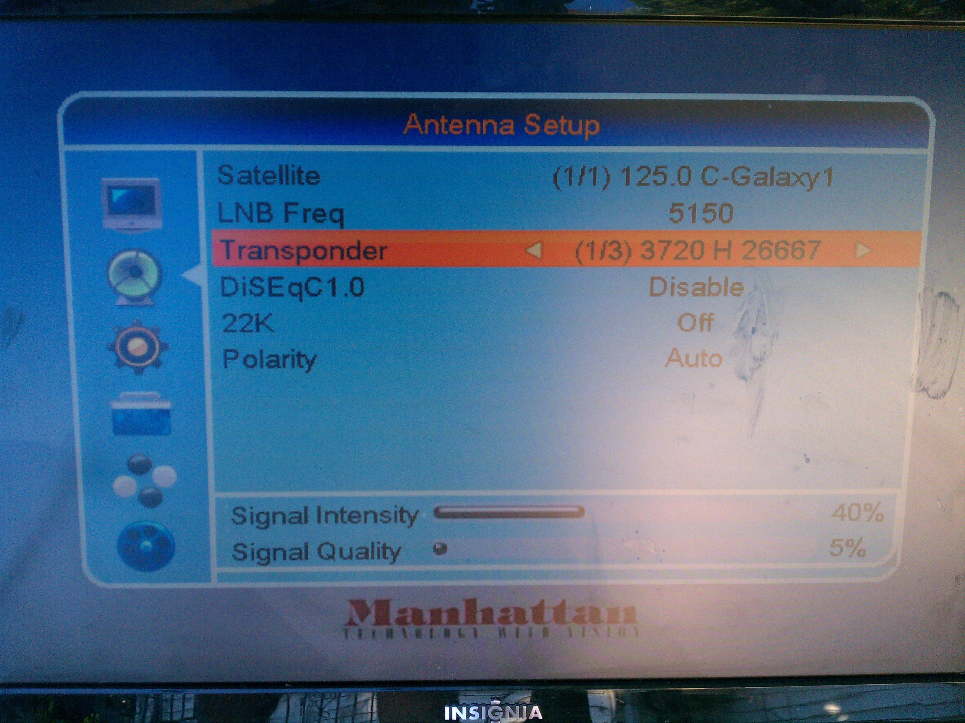

Yesterday I spent a good part of the day outside working on my DISH and in doing so I found a number of issues with the Manhattan receiver.
One of the biggest ones is this issue, where I have it set to scan KU, yet it continues to to scan in C Band... but what makes it strange is the frequencies shown on the screen at KU Frequencies!
The LNB is a BSC621-2 and the KU is on Diseqc port 2. I have this setup this way in the settings on the Manhattan box..
I have only got it to scan in KU once, every other time I try it grabs the C Band instead.

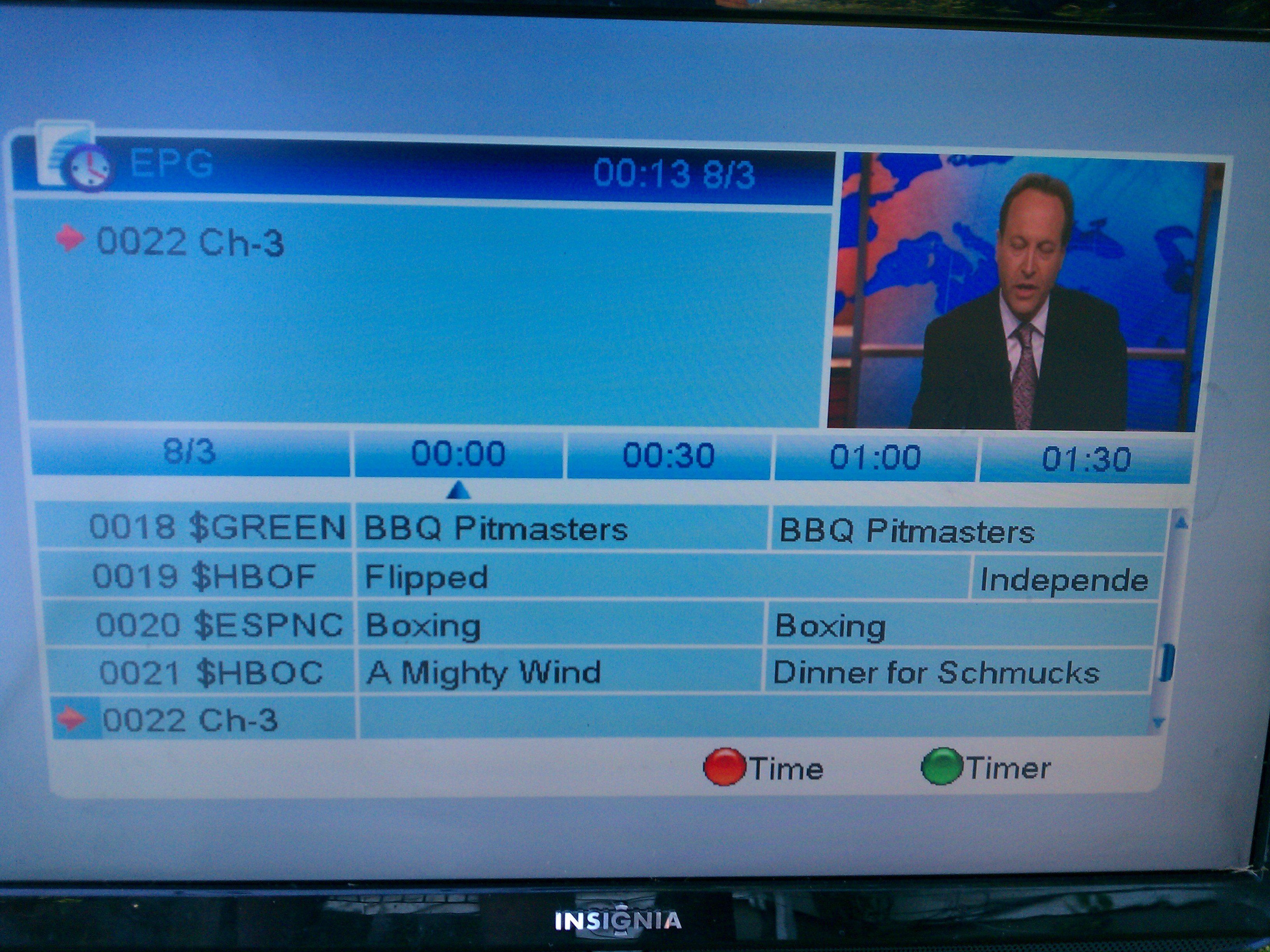

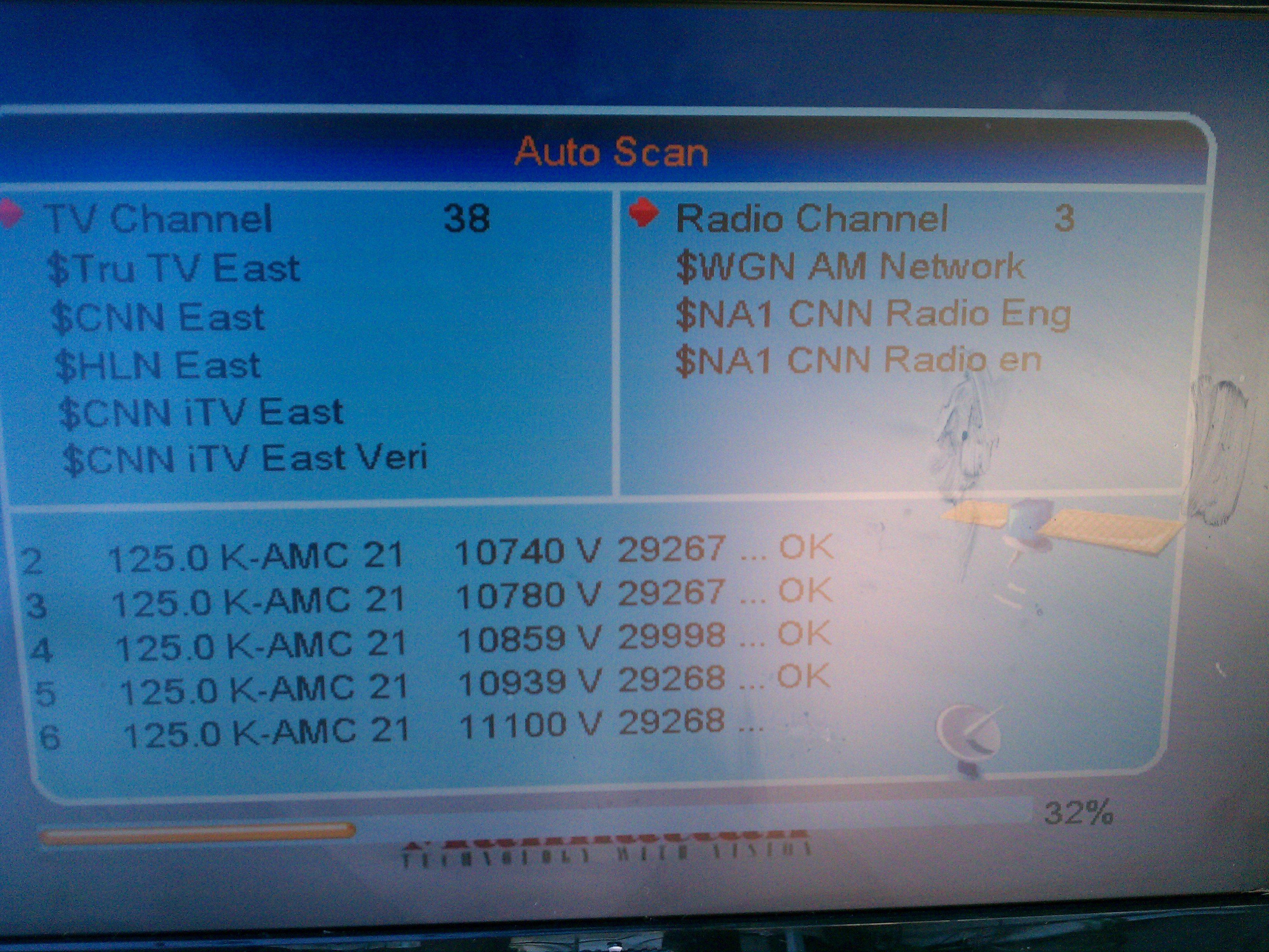

Picture 1 shows me scanning KU band but for some reason picking up C Band instead (even though the box is reporting its picking up KU signals... (HUH!?)

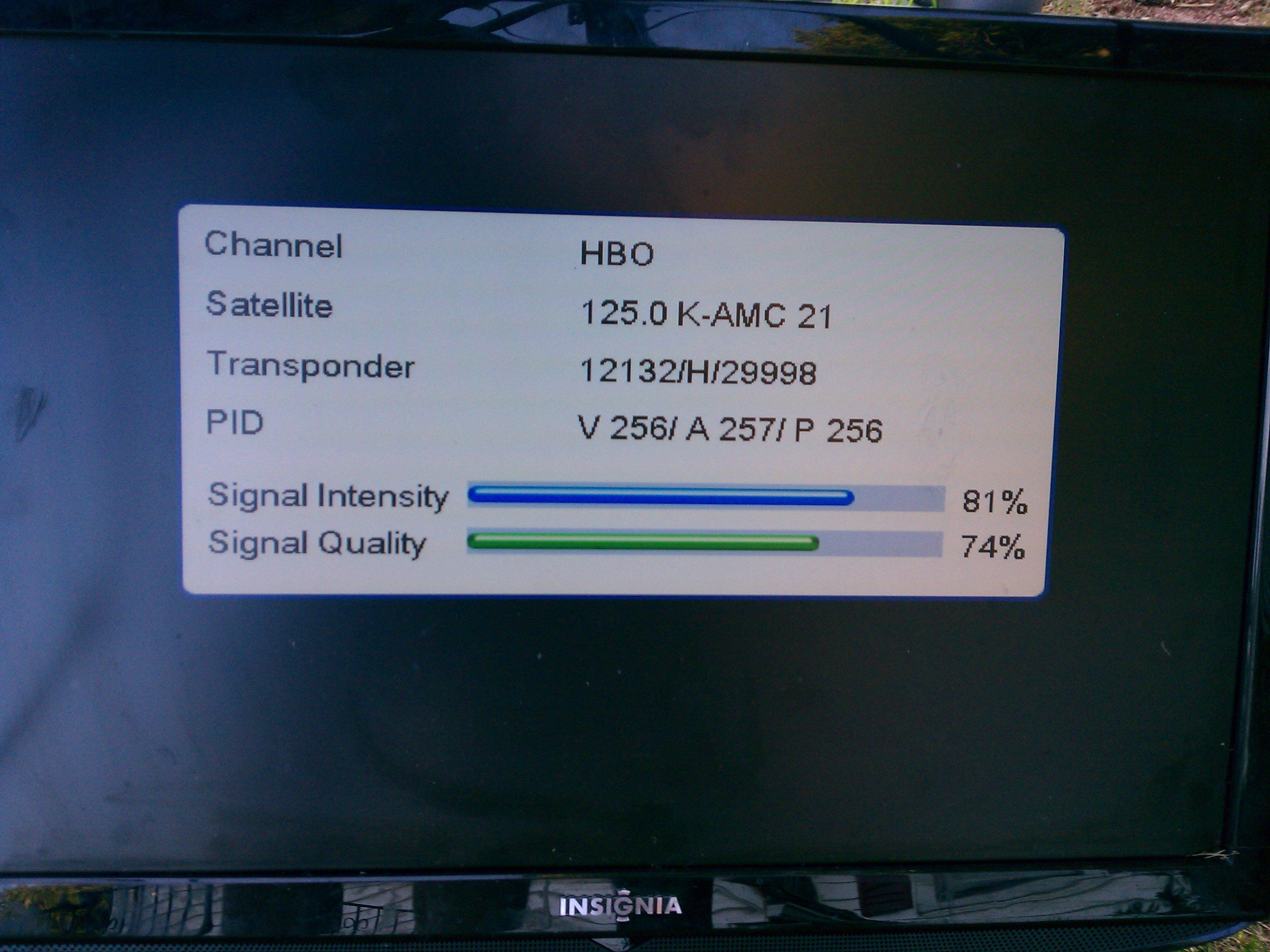

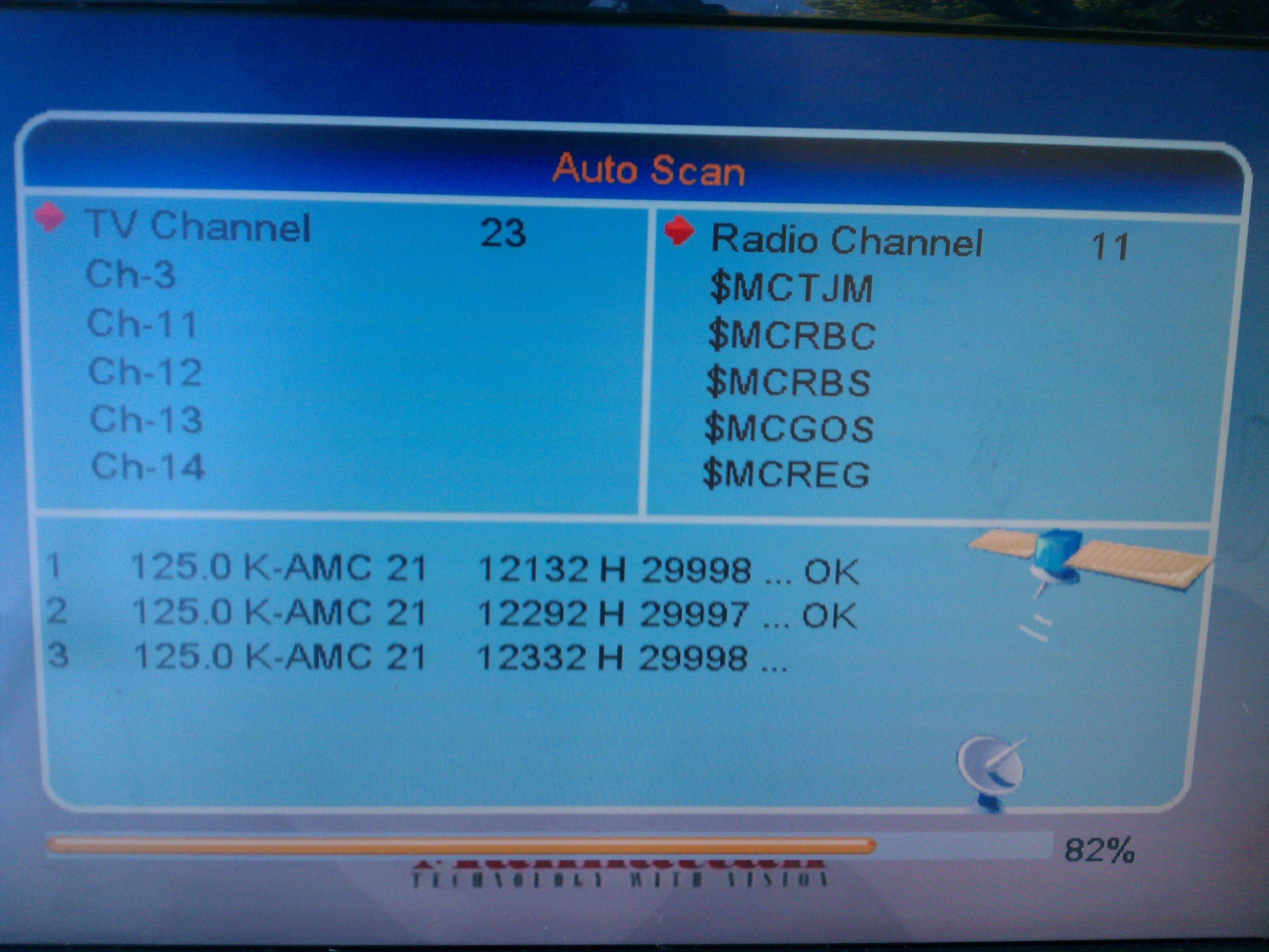

Picture 2 shows me scanning again but this time actually scanning KU (Found a bunch of HBO's on KU!)
Picture 3 Shows the EPG showing programming on the HBO channels I found.

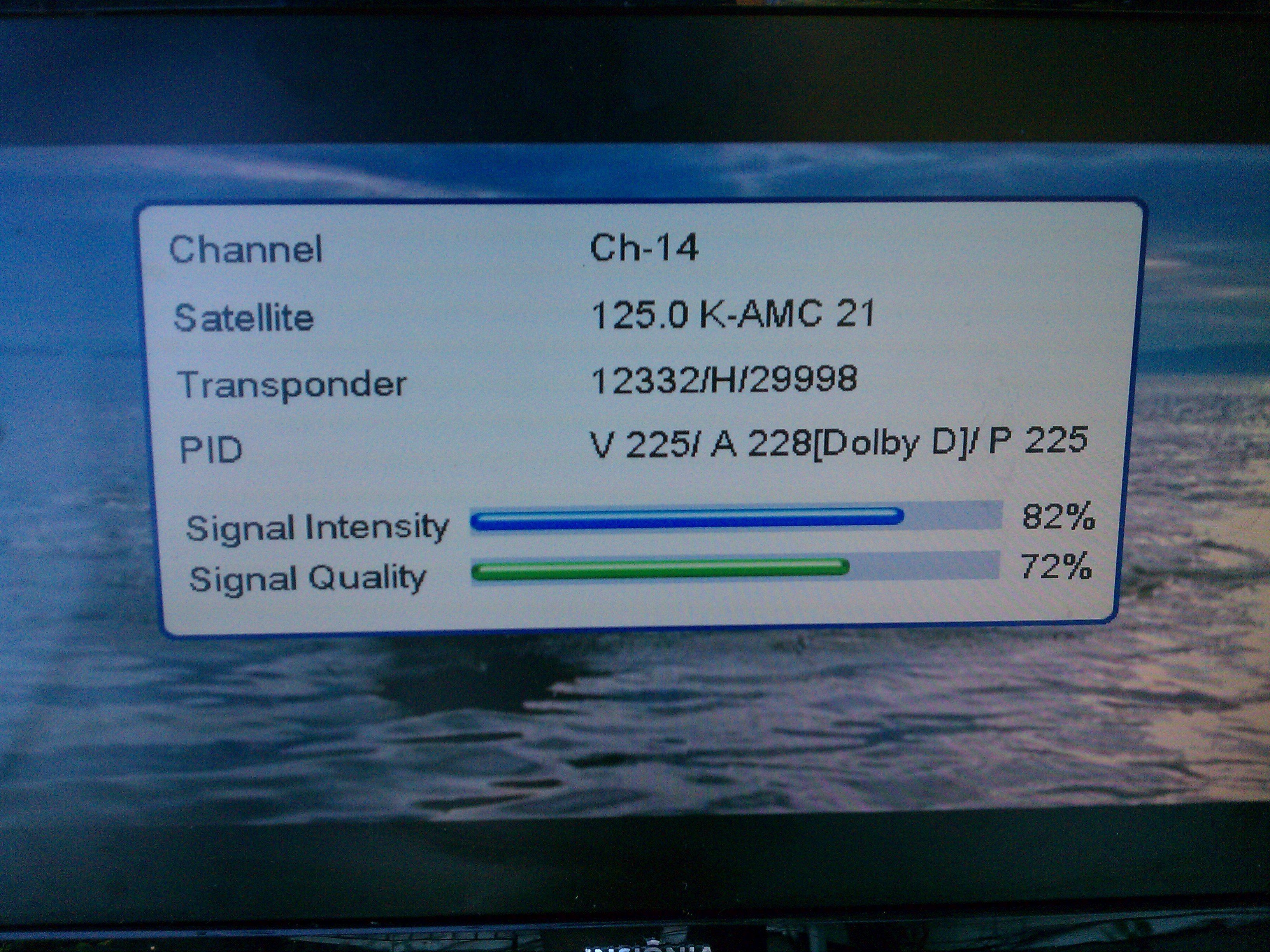

Picture 4 and 5 shows you the signals I am getting. :)

Another issue I found is that the signal meters on the Antenna Setup Screen does not always work.
This one had me confused for hours. I had a great signal on my SuperBuddy Meter but when I plugged it into the Manhattan it would not show a signal on the Antenna setup screen. I was close to calling for an RMA as I thought maybe the tuner was bad. The finally I said what the hell and did a scan... and it found the transponder and scanned in everything fine. Going back to the Antenna setup screen again for the signals it just found it had no signal reported. In fact I removed the coax fom the Manhattan and the signal levels shown on the screen were the same...
Very odd to say the least...

If , for example, the Cband data is available, while the Ku side is being scanned, the receiver , picking up the "leaking" data is going to assign Ku band freqs to the resulting scan ( and channel assignment) . The polarity and symbol rate will be correct, but the freq is just logged according to where in the Ku band the receiver is when it picks up the spurious signal.
I used to have the "bleed over" problem with my Pansat 9200. I just ran two lines from the lnb to the house and hooked up a diseqc behind the receiver. Doing that stopped the problem for me. Now my dish is primarily used by my 4D receiver and my Manhattan is slaved to it so my circumstances are different as the 4D receiver controls the polarity as opposed to the Manhattan. The Manhattan however selects the band..... Have a great day!

The receiver scans a set of IF frequencies (950-2150) and logs channels. What frequency they show depends on the LNB LO frequency. It doesnt care what you put in there...if it picks up a signal it shows
I could take my C-Band dish and say 11250 as the LO (like a DBS LNB) and scan....and it will pick up the frequency weird but still show it.
Here is how to prove it
Take the frequency shown on the screen...say 11100 and subtract the LNB LO (9750 in the case) and you get 1350. This is the IF frequency
Now take 5150 (the C-Band LO) and subtract the IF frequency (1350) and you get 3800
Check lyngsat or the list and 3800 has those CNN channels that show up on the screen scrambled
