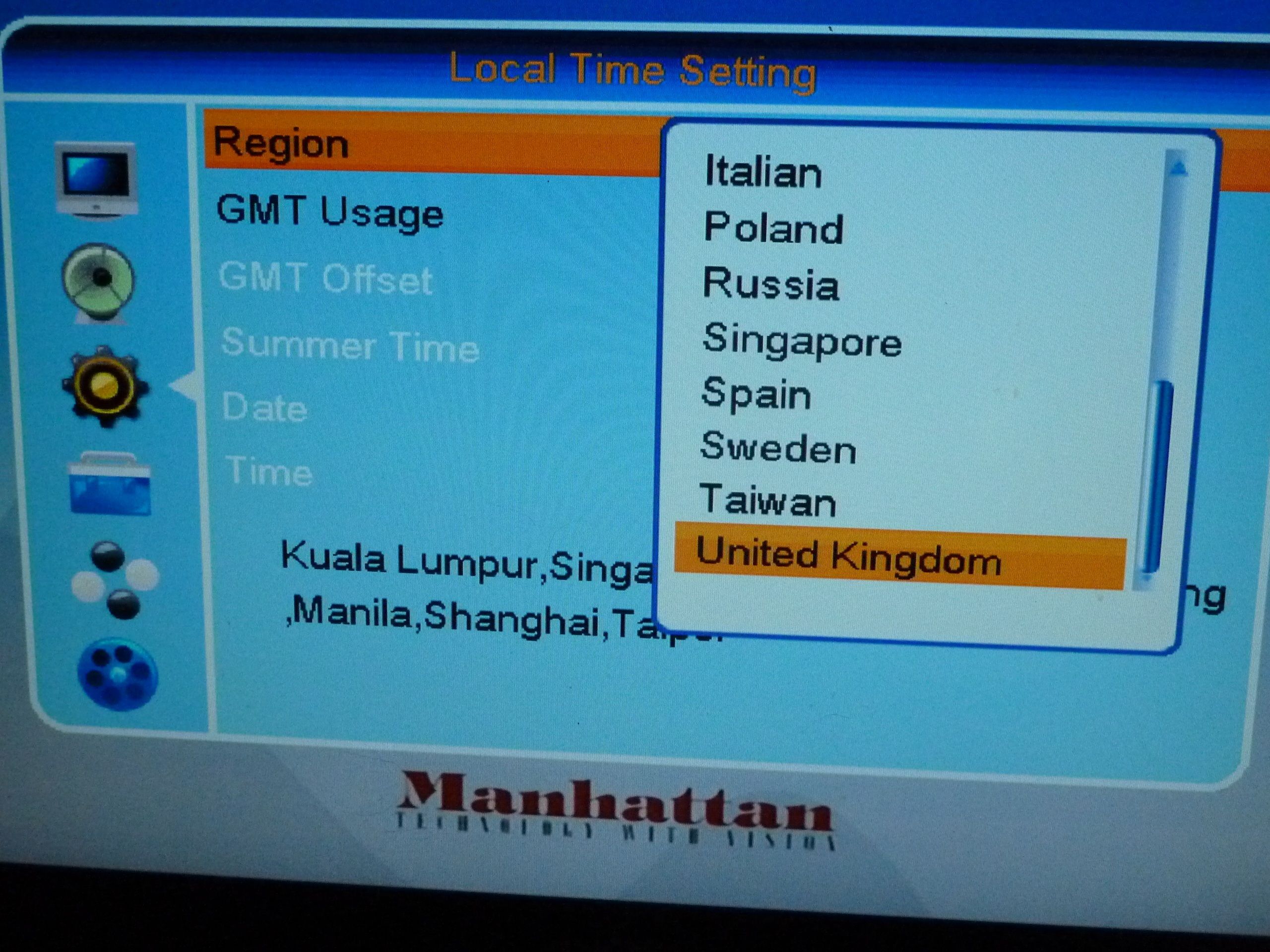

People say that the clock on the Manhattan works, but for me I can't set the clock to US time. It does not have the United States as a selection in its menu.

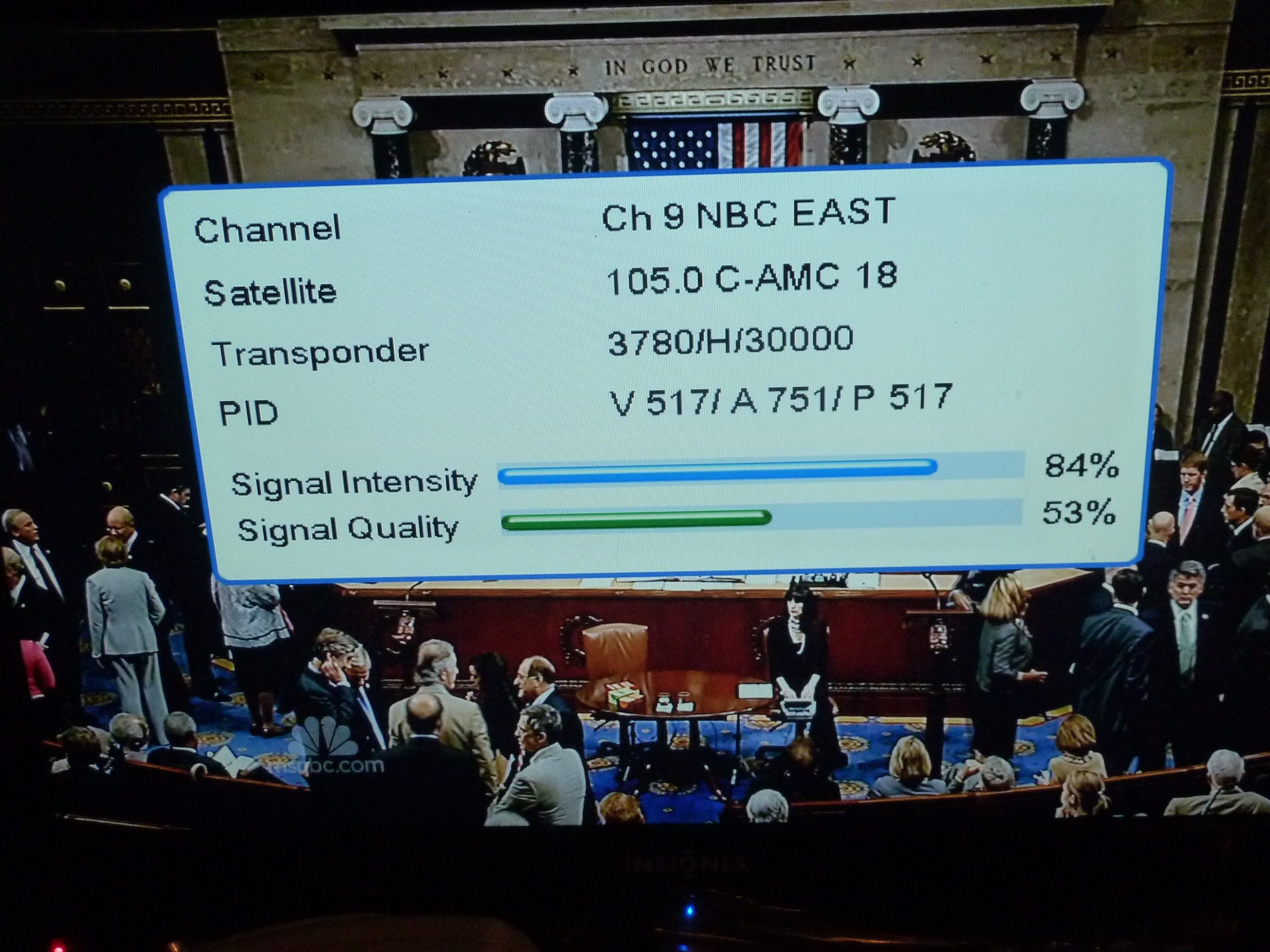

Watching NBC the picture was clean however at times I noticed some stuttering, I never had this on the AZbox. (On the AZBox when it was having trouble with the signal it would pixelate. I guess stuttering is better then the screen turning to boxes.
I went and checked the signals to compare it to the AZBOX on 3780 and I couldn't do it... when I hit the info button twice the signal quality was bouncing all over from 21 to 62%
The fact that it gets Telemundo tells me the tuner is more sensitve to pick up then the AZbox, but with bouncing signal levels on the Manhattan its hard to tell how much better they are.
So far besides the stuttering on NBC East, I am impressed especially with how quick the blind scan is!

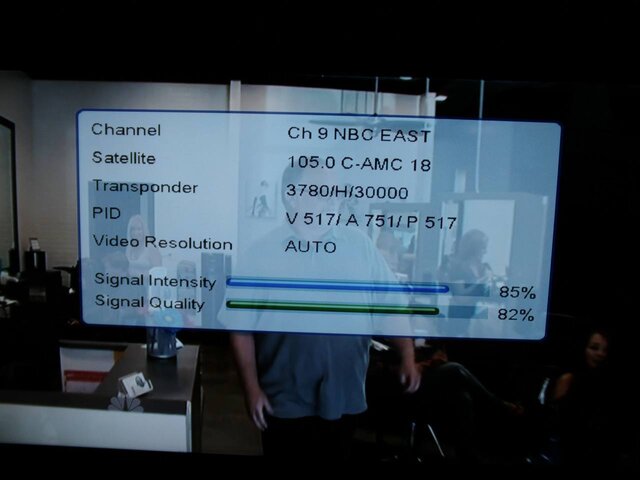

To set the clock do the following... set the GMT usage to off. Then go down and set the clock and date. Now if you set the GMT for user define you will see several locations on the screen as you flip through the hours. But I couldn't get the initial time set. So for now I just set GMT to off.
I also havn't noticed any stuttering on the 105, but to be honest I havn't spent much time there. I will go there now and grab a screen shot so you can see what I am getting.

Hi Scott,
For the clock- Go to Local Time Setting- Don't worry about the region
Arrow down to- GMT Usage - Select- User Define
Arrow down then right arrow to choose your time zone..In my case -05.00 for Eastern time.
And Summer Time on.

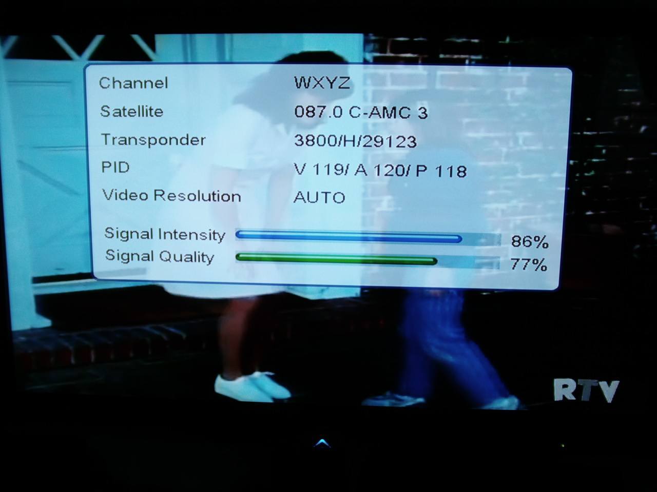

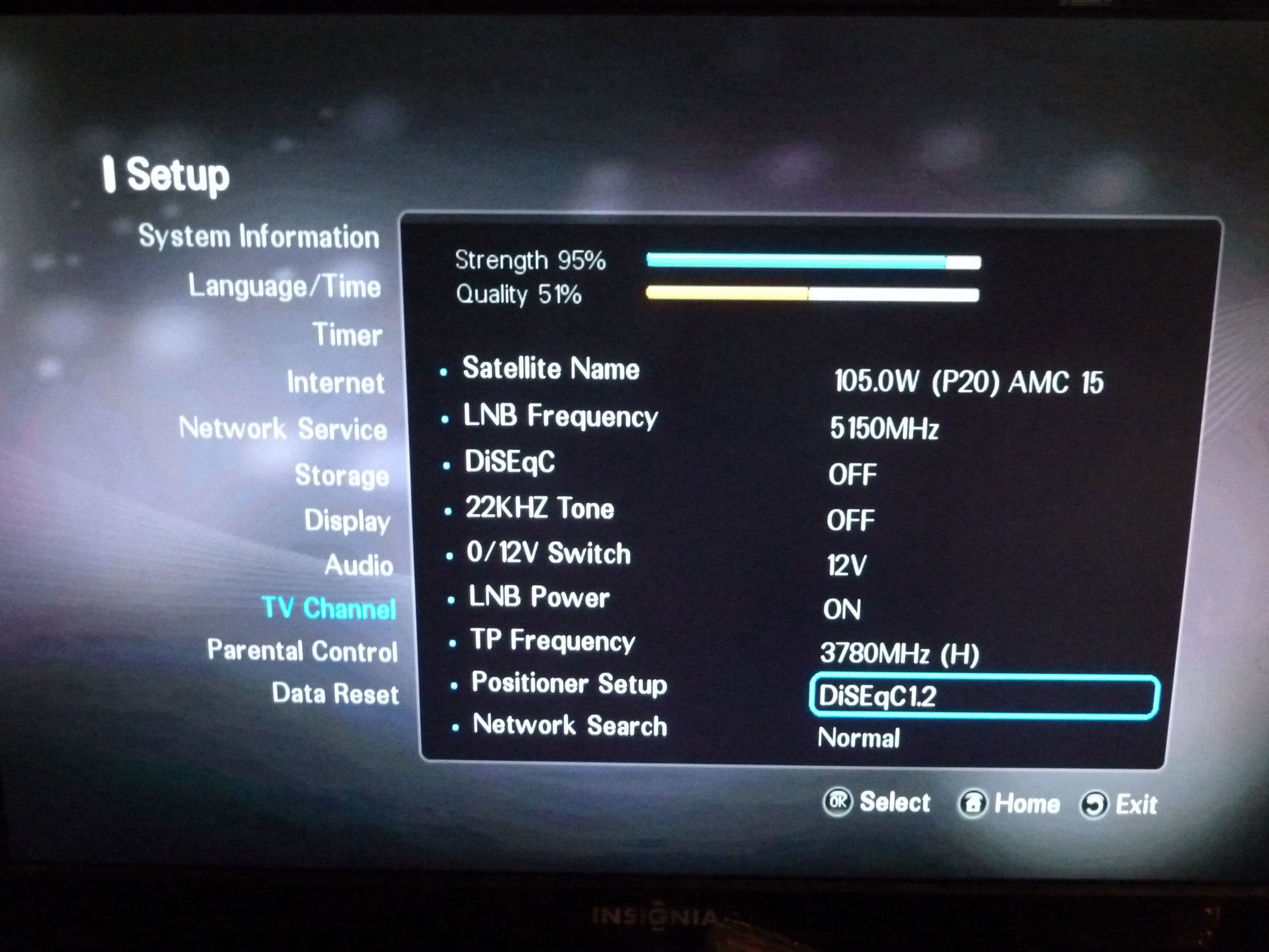

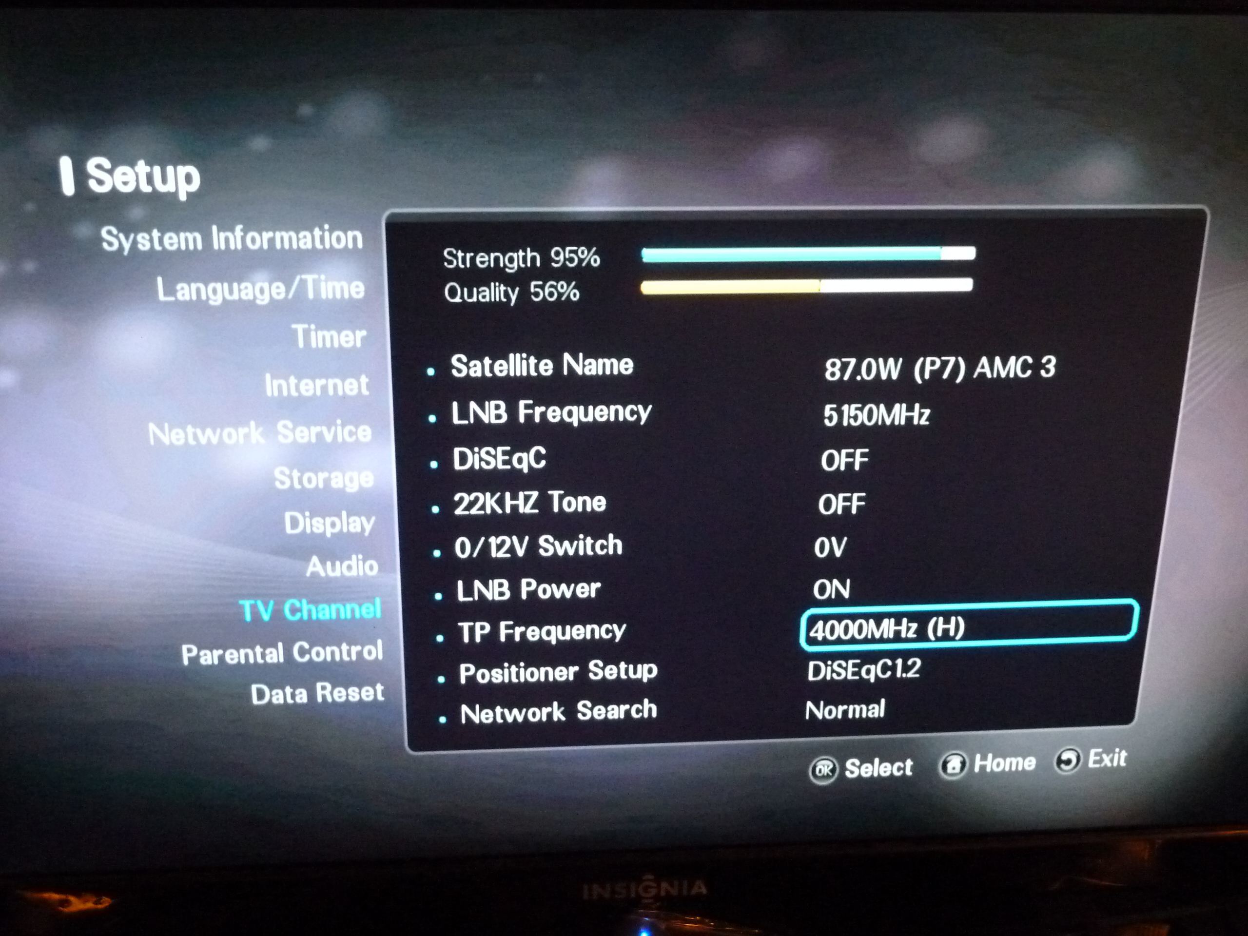

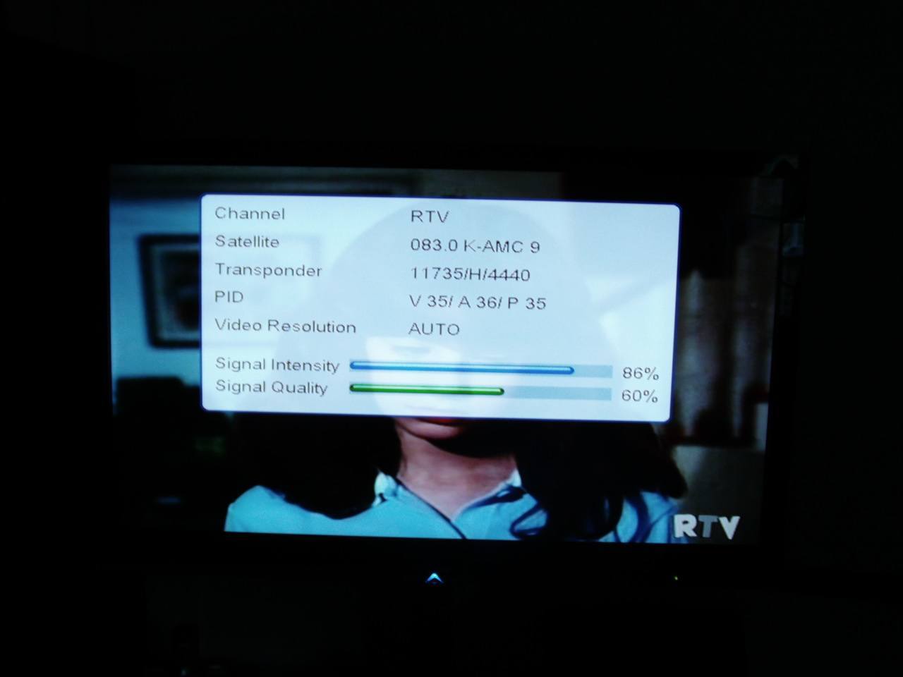

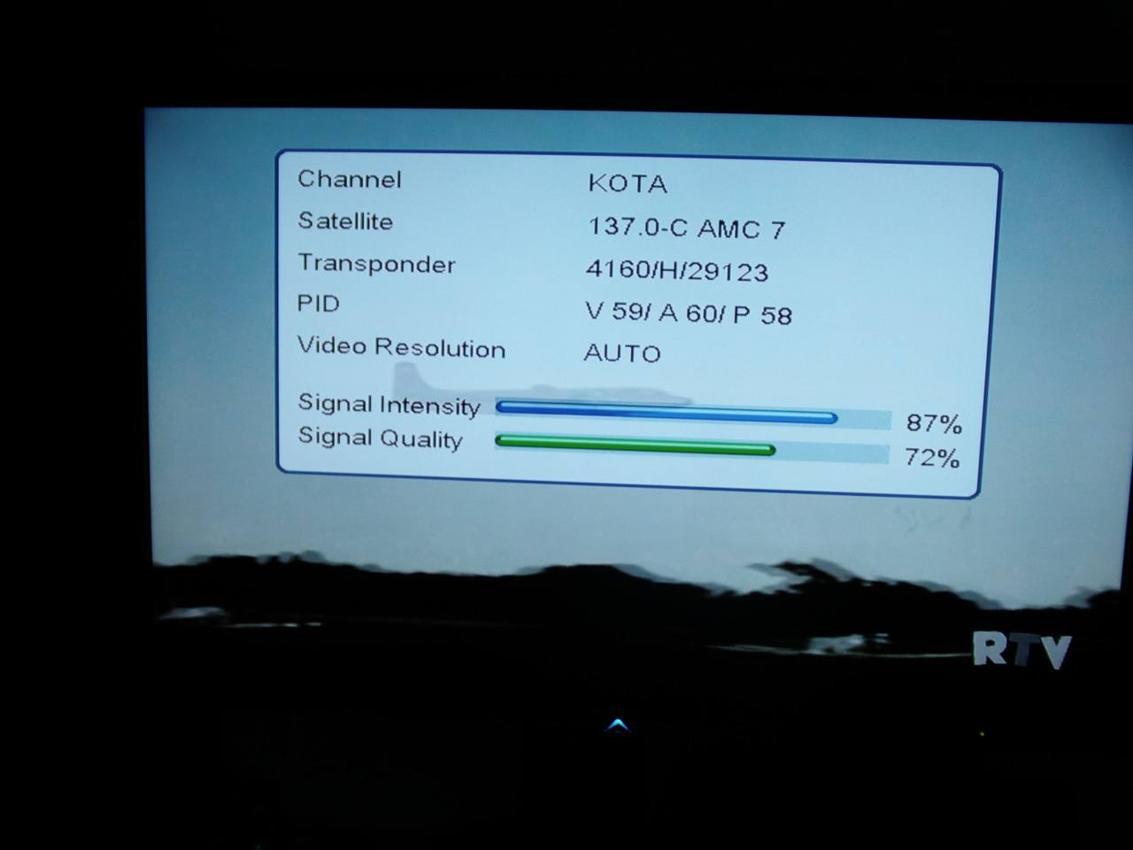

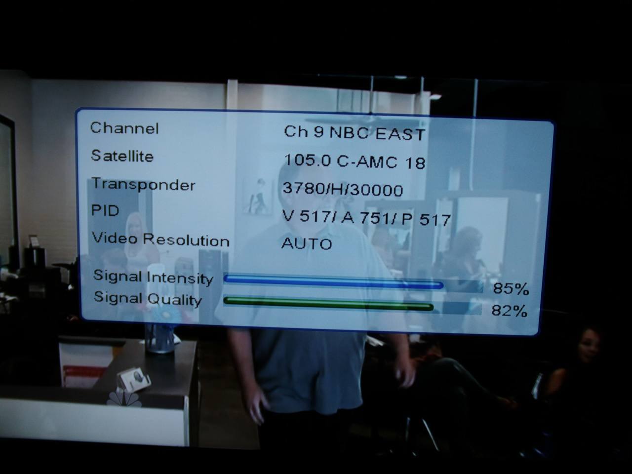

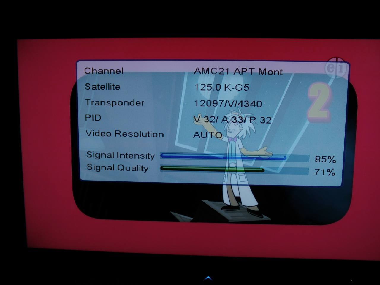

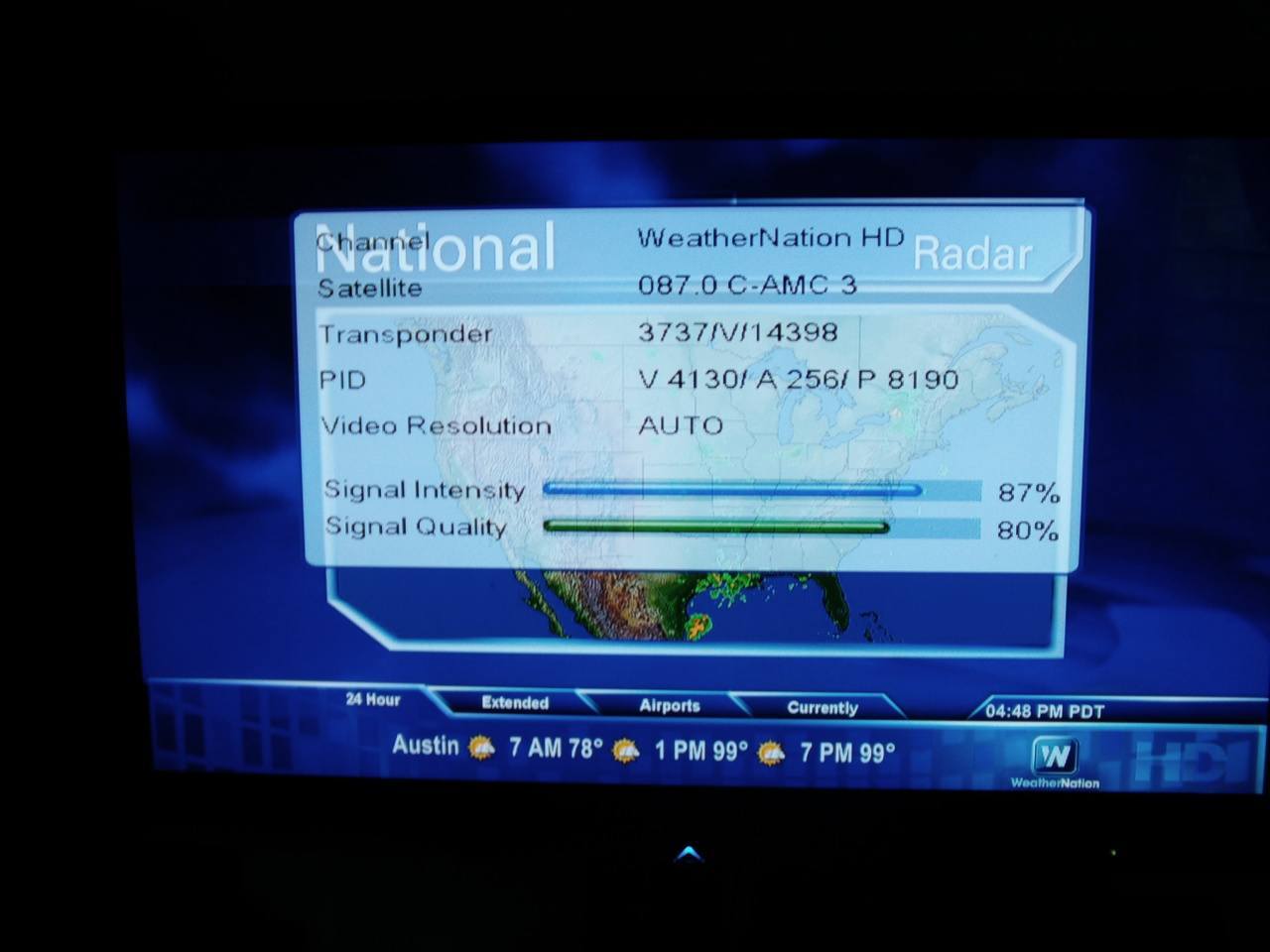

Here is some screens of what I'm getting....

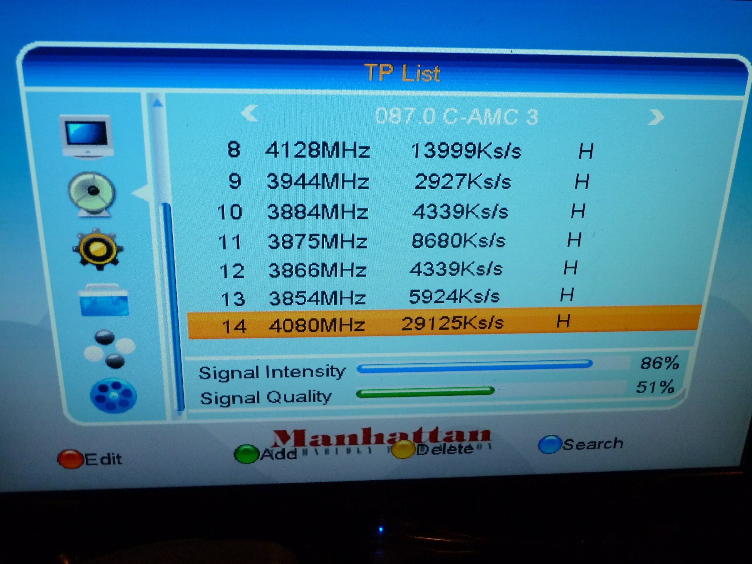

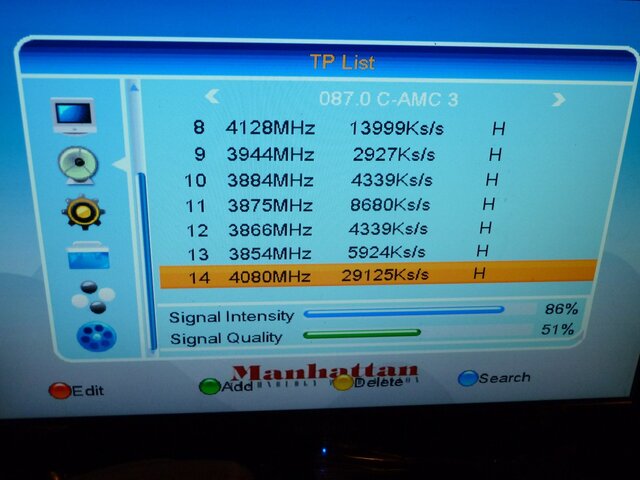

Well I just did a scan of 87 with mixed results.
No RTN even though I have a 51 signal quality on the transponder. But the AZbox couldn't get it.
It did pick up on ME TV, which I forgot all about and didn't have programmed into my AZ Box.
Also found another interesting channel which I have not seen before, GVTV (Gone Viral TV)

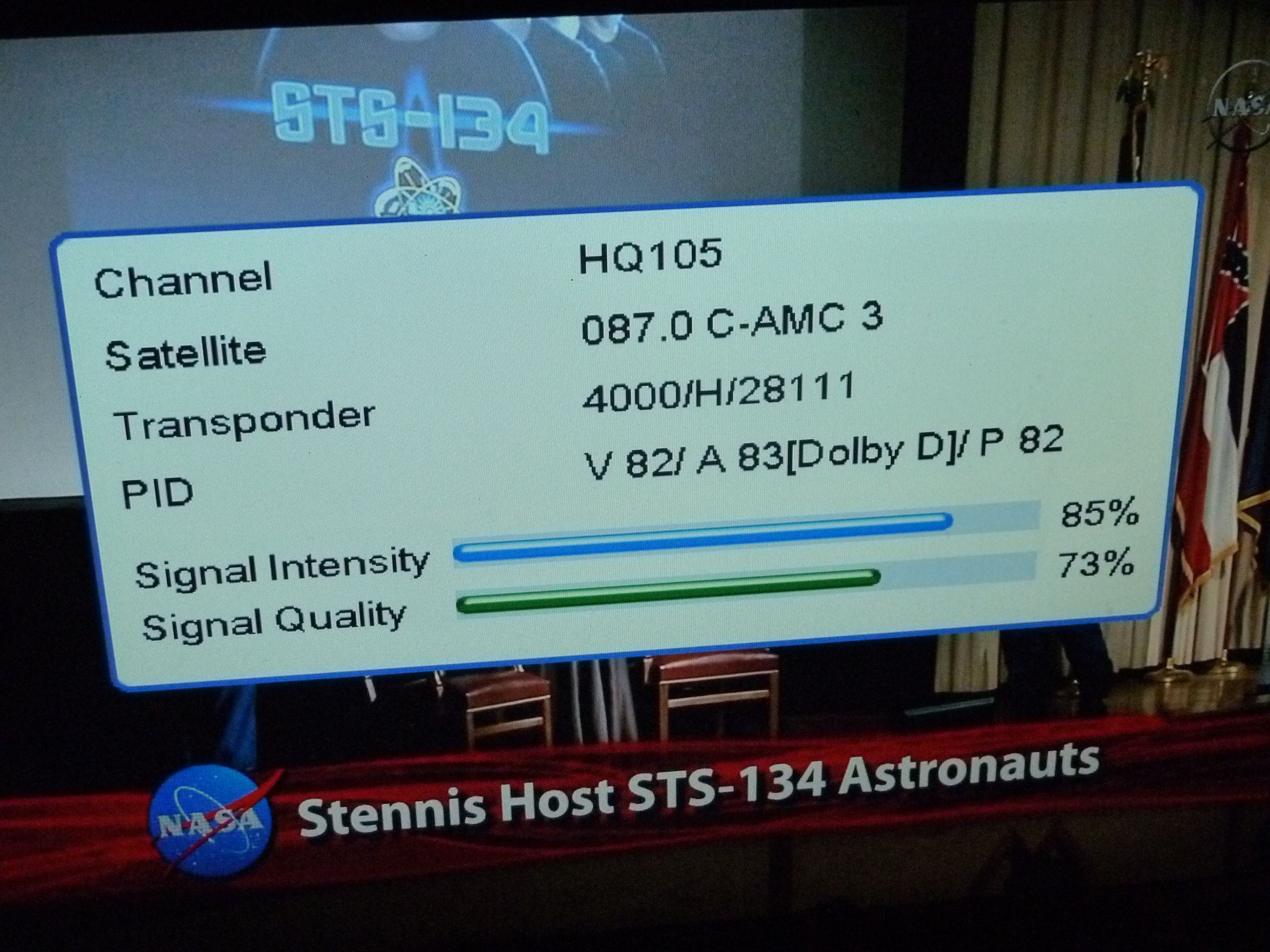

On the AZBox was getting the NASA Mux at 56% but on the Manhattan I am getting it at 72%.
couldn't get it.
Me thinks you need to tweak that dish my friend..... The screens I posted cover amc-9 ku, Amc-9 C, AMC-3 c, the 105 and the NBC channel... (no stutter) AMC-21, Mont pbs Ku, and then shot off to AMC-7 and took a pic of the rtn stations there. My weakest link is the rtn channels on amc-9 ku. But they still at 60% or so. My signal is solid. By that I mean only a couple % fluxuation. Also my shutter speed was turned down on my cam. So some of the motion on the tv was blurred when I took the pics. My main objective however was to get some meter shots for everyone to see. Have a great day!
Nothing at 3737 (Weather Nation) or 3800 RTV on 87.
But remember my DISH is kind of borked at the moment. Hopefully I will have time this weekend to go out and work on it. :)
