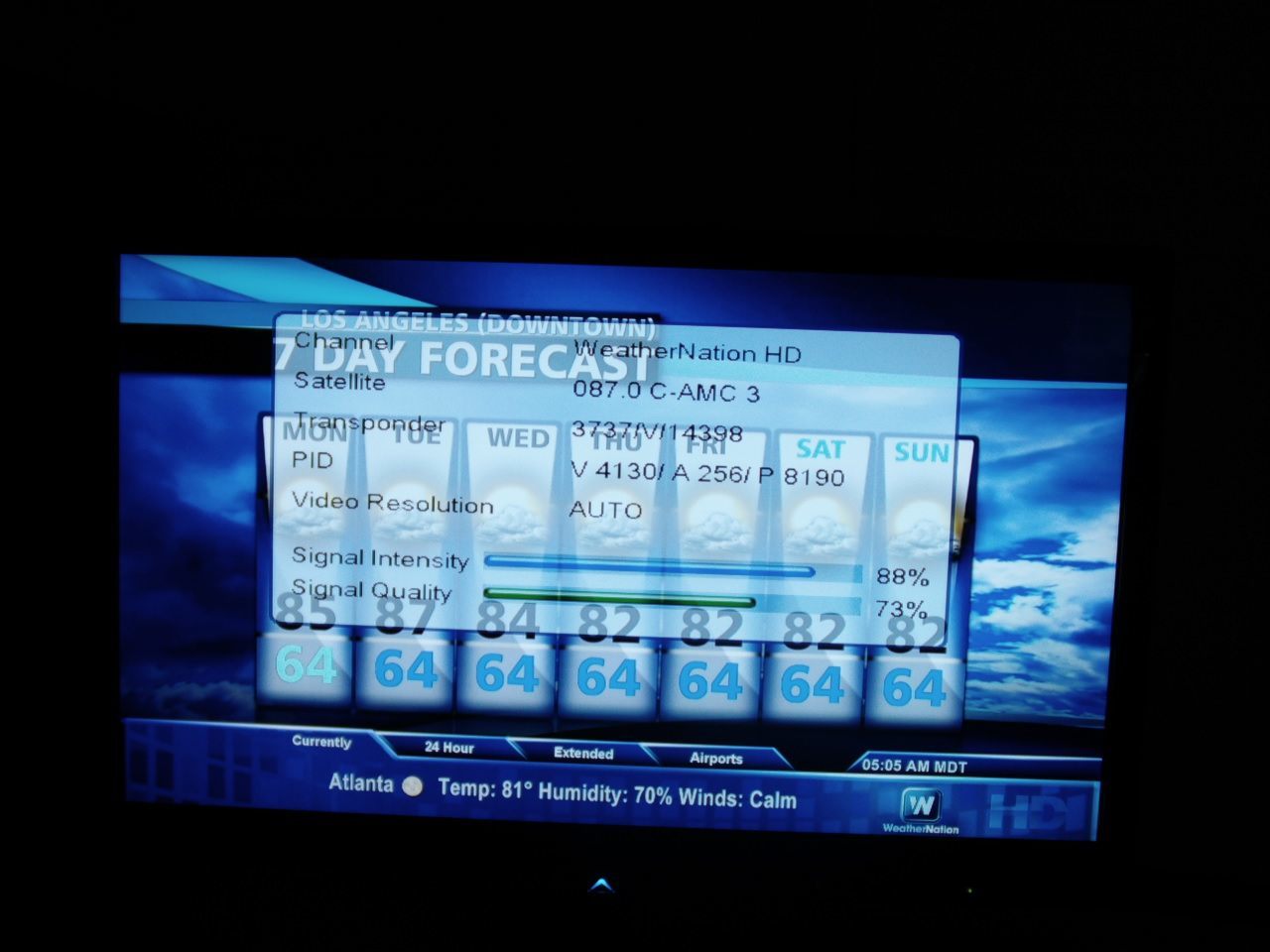

Weather nation HD scanned in fine with me, you could try going to 3732 H 5632 and bump the dish to see if you can pick it up.
I tried both frequencies and symbol rates and still got nothing. Signal level was also non-existent. Others give me signal 85% with quality 45 with some 83% and 71 quality. This is with my dish peaked on the sat.
SANY0018.JPGSANY0018.JPGYou are not as peaked as you think, or you need to check out your setup... Just took this this morn..... Bear in mind that I run a 10 footer..... Have a great day!

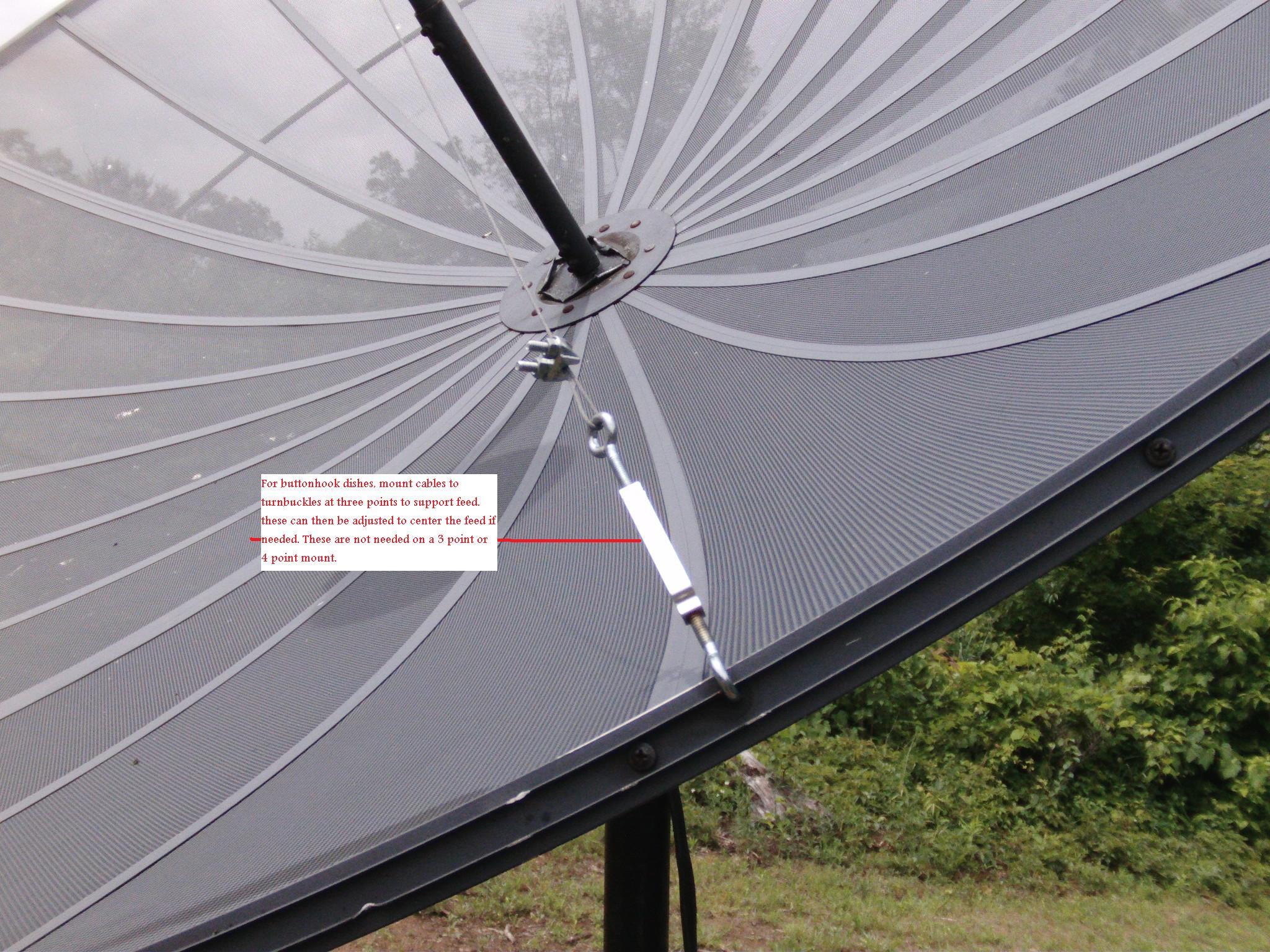

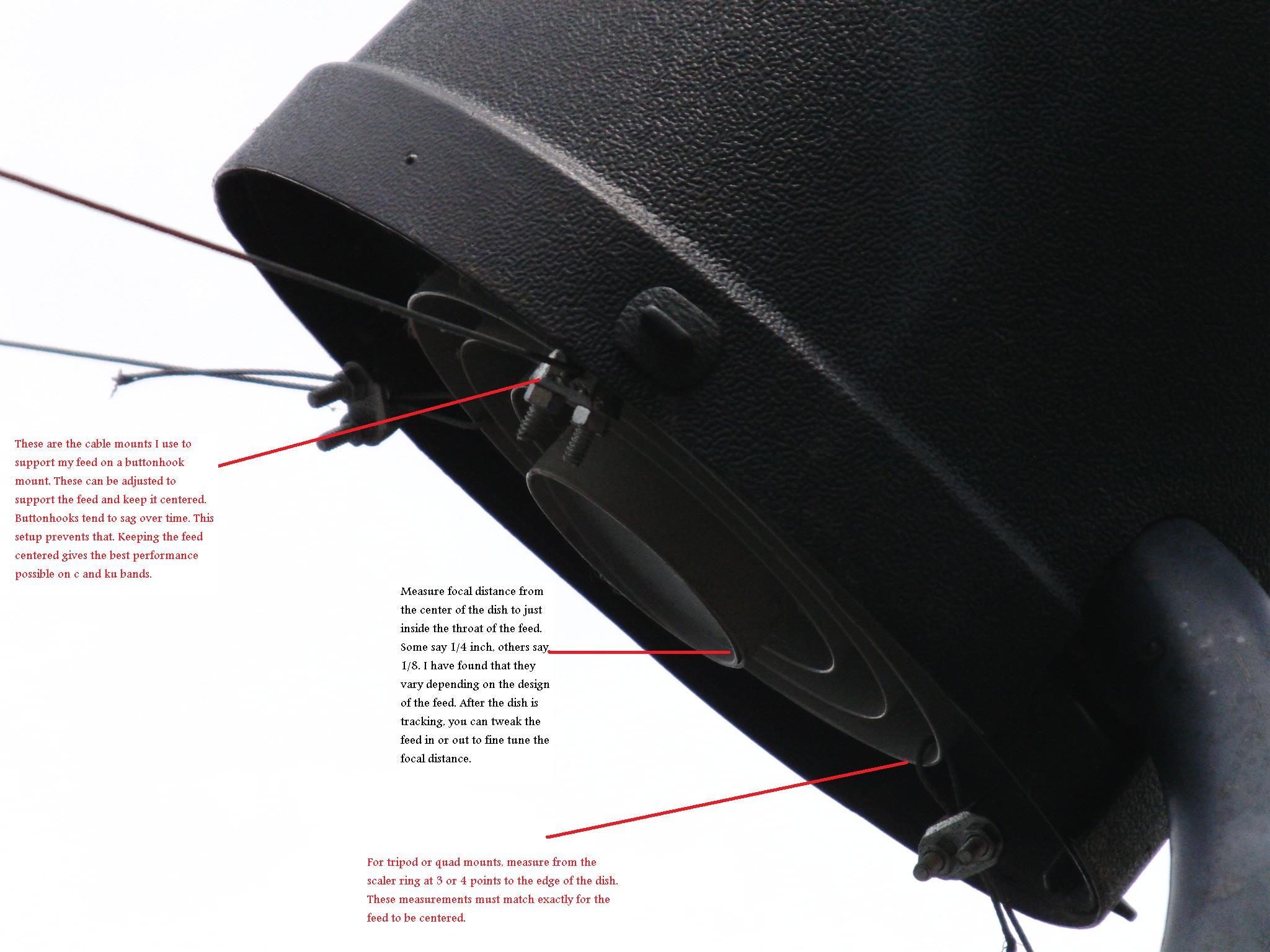

You mention having a buttonhook mount. May I ask if you are still centered? I have the same setup. Being that those arms like to sag, I took cables and turnbuckles and mounted them to three points on the dish. By adjusting the turnbuckles, I can keep my feed perfectly centered and supported at all places along the arc. A feed being just ever so slightly off center can cause problems.

Yes, I am most likely going to do the same with my dish. Cables and turnbuckles. Thanx for the photos. My avatar is a photo of my dish.

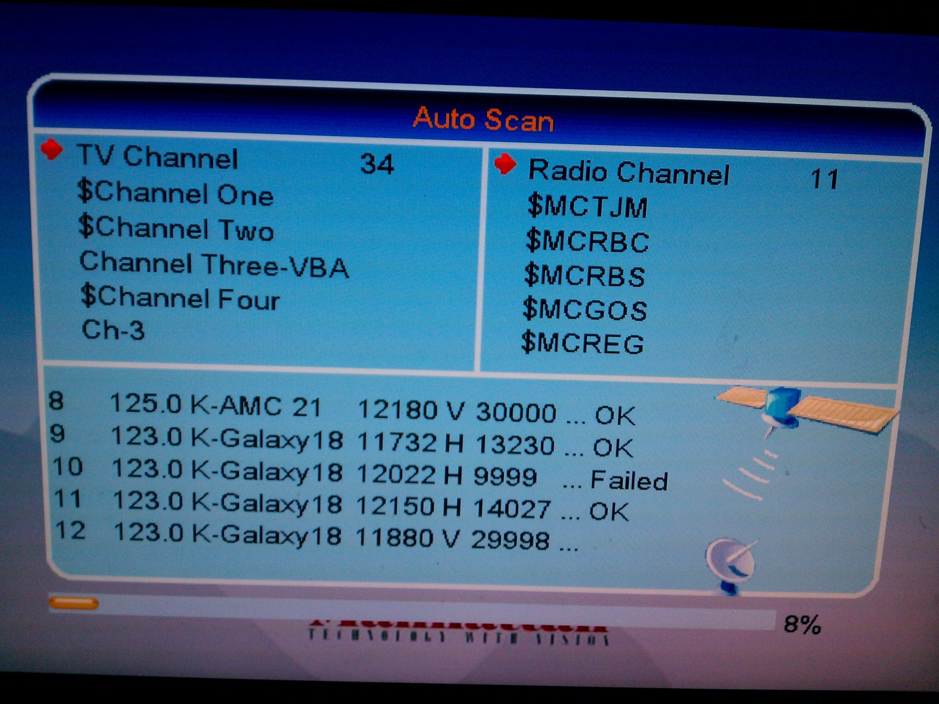

I got my KU dish nicely running and its scanning the entire arc nicely. Most of the arc the quality is above 85 and the signal 70 or above.... (I am happy with that)
So Now I an doing an auto scan and I am noticing that a LOT of transponders are failing when scanning.
After the scan is complete I go to those transponders and the signal is very high and so is the quality.
Any reason these are not scanning in?
