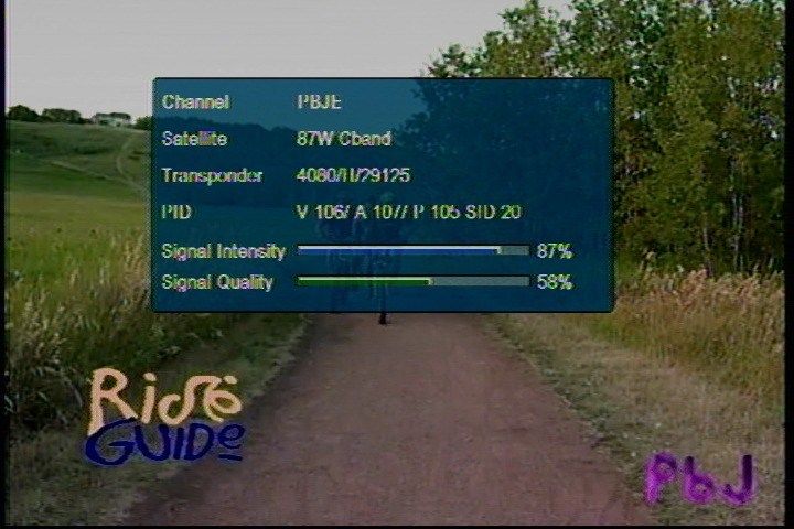

Well I've got PBJ and all the stuff on 4080 again.
I "bumped" the dish a little and it came back.
I think I need to do some more physical tuning on my dish. It's just so extremely difficult to get to the LNB way up there.
I need like a platform that I can walk out on so I can get into the dish. Like a diving board.
Standing on a ladder, I can just barely reach the LNB. It's not so much the height, it's that the dish is so big around it's hard to reach that far into it. :(
Maybe my dad can help me build something for my John Deere that I can drive up to the dish then walk out into the middle of the dish.
There are definite disadvantages to having a 10' dish. I don't know how one can possibly work on 12' or bigger dishes..

Well I've lost 4080. Again.
Me thinks some big kid is playing with buttons and switches in Mission Control somewhere in Tennessee.
Like a kid playing with a light switch. :(
Please. Stop..

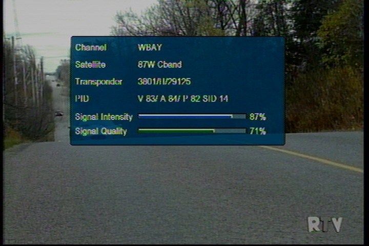

edit: On the other hand, 3800 is stronger now than I have EVER seen it! Rock solid!
The signal holds steady at 87% SI / 72% SQ. It no longer fluctuates like it used to. I could not ask for better.EVERYTHING on 87 is coming in really, really strong now. However, 4080 is "NO SIGNAL" for now. And that is a bummer because PBJ is only on 4080, it is not on the 3800 transponder.
And where I am, in flat land with idiot neighbors that let useless Chinese Tallow trees grow like weeds, there is no way possible I would ever be able to pick up the Alaskan satellites. I would have to cut down every tree for a 1/4 mile then put the dish on a 30 foot pole. Not gonna happen..
Come on Mr. Luken, turn 4080 back on. PLEASE?????? :cry:
