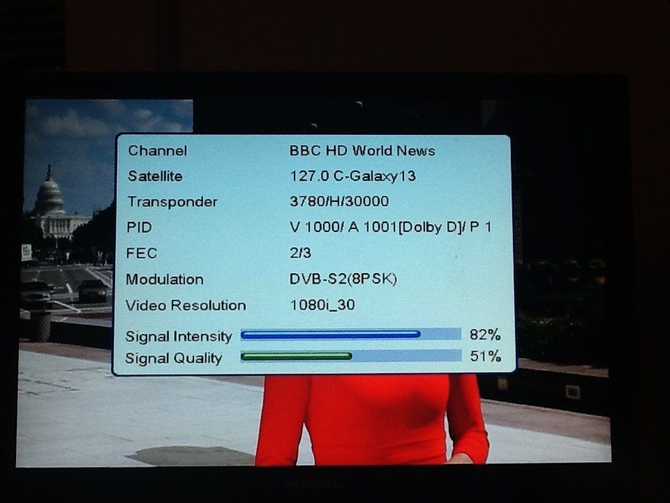

Thought we could start a new thread about reaction to the Manhattan 3.3 update, date 30 Sep 2011. I've loaded it on two receivers, and am happy to see the 22khz control in all motorized and fixed menus. Haven't found any issues, yet. :)
The info key "i" now displays resolution of the signal, if it's HD , and modulation scheme , dvbs(qpsk) , for example. as well as FEC. Have to check it on some signals, good addition. :)

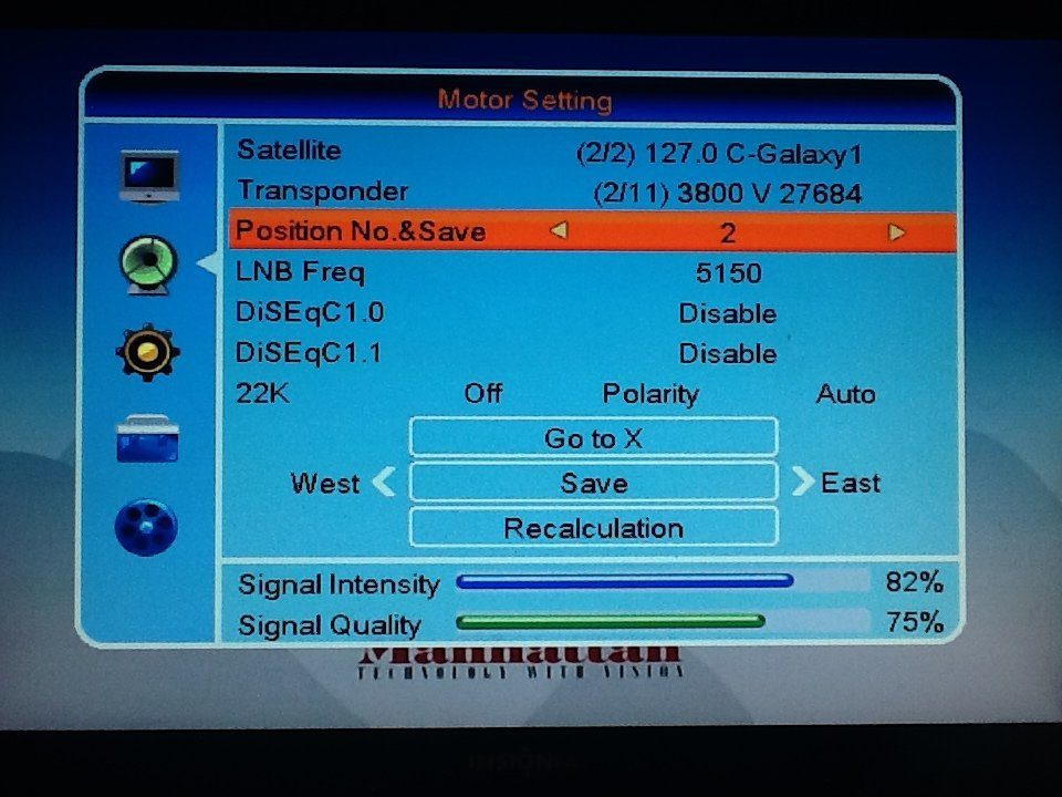

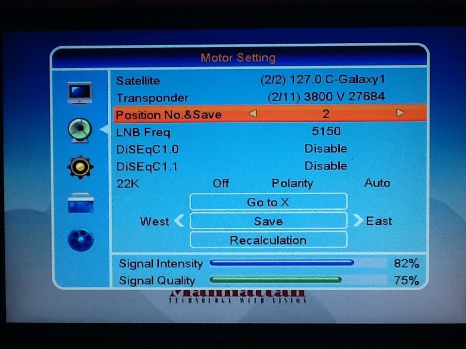

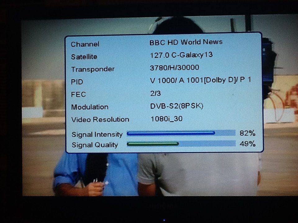

I love the new info screen... also a shot of the new motorized setup screen. :D
Dang it must of had the iPad upside down... Let me fix that. :D
that signal bar sure looks little...
Whatever happened to nice BIG ones like the coolsat had?
