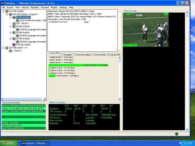

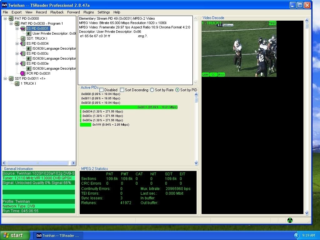

More ammunition, I used Tsreader to RECORD the program, and then moved it to a usb stick. The Manhattan and Solomend 800 cannot play back this stream. They act the same way. I'm thinking some sort of copy protection, since there is a "private descriptor" in the stream, but I'm not smart enough to know. :)
Mistake in data read
I had a chance to view, record and analyze the signal on Saturday. No copy protection on this SCPC signal.
0x86 is a Caption Service descriptor and is not related to the video issue.
The signal doesn't have a high enough bit rate to seem to be a problem, but nonetheless , the recording doesn't play back on either Manhattan or Solomend 800, though Tsreader has no problem. Another of Iceberg's little mysteries. :)
