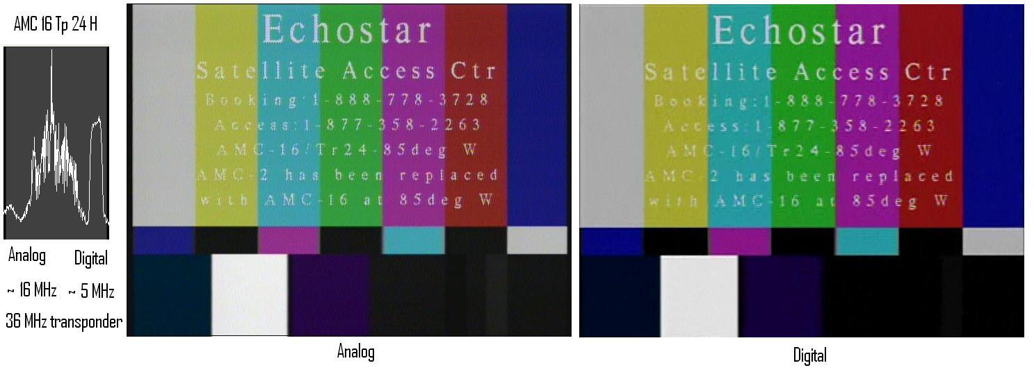

Here is a comparison of the analog color bars vs. the digital color bars on AMC 85.0°W AMC 16 Ku.

The spectrum scan is from my BLSA. The digital image is from my Twinhan PC card and VLC. The analog image is from my Toshiba TRX-2220 S-Video to my ATSC Tuner card that has S-Video and then I used VLC to get the screen capture.

Interesting!
The analog signal seems to have better definition on the number edges, and lower color saturation, to my eyes.
I suspect the analog image is "better", but then again it takes up quite a lot more bandwidth than the digital channel?
Look at the lower right section of each picture, where various shades of dark grey to black are displayed. I can make out much more detail on the analog side. Am I just imagining this, or has some of the fine shade detail been "compressed out" of the digital image?
Its no secret that 4X3 analog is MUCH more pleasing to the eye than digital.
Those of us that remember the heyday of analog c-band remember stellar PQ was a selling point (ah, memories......)
Analog just isn't all that efficient with TP space. :cool:
