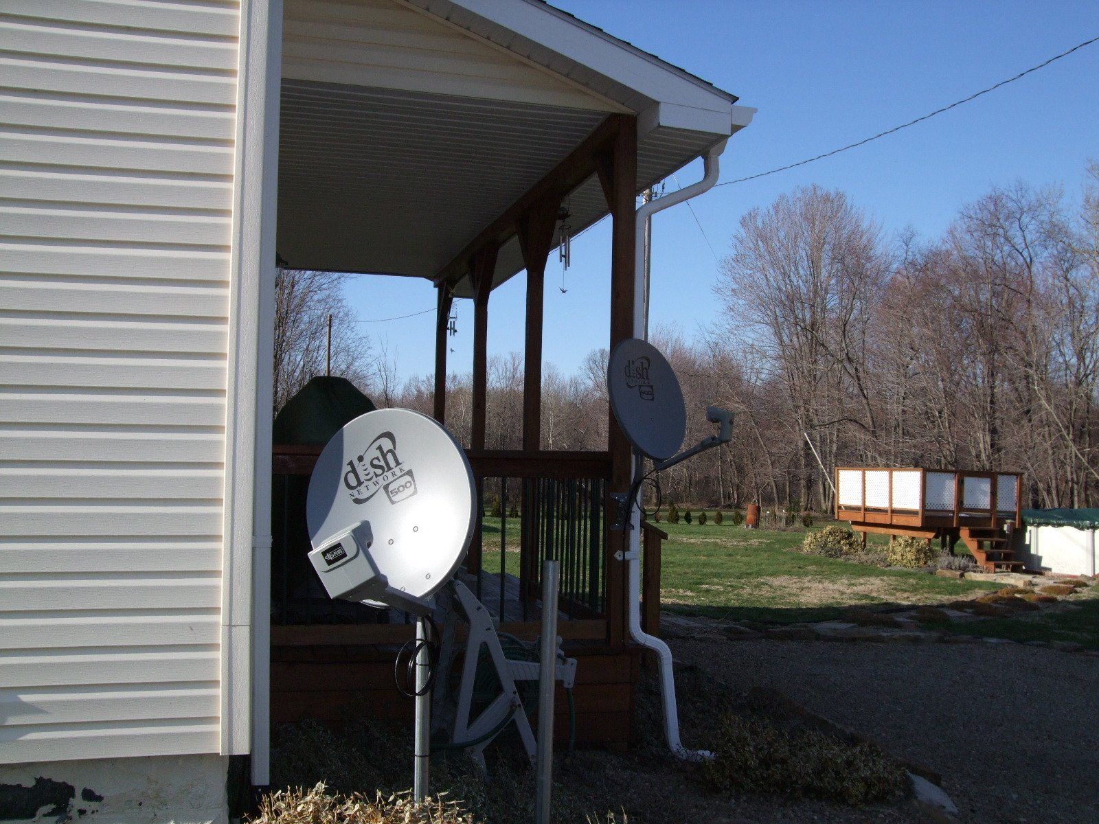

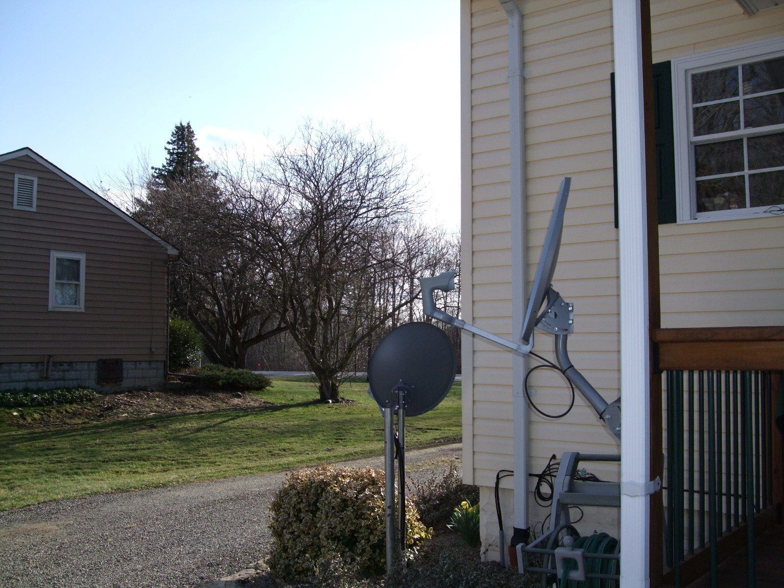

Well, yes, that may be part of the problem, but the installer could have replaced both with a 1000.2 (which should have been done if you're paying for it) or moved the D500 pointed at 61.5 to the other side of the D500 pointed at 110/119. No LOS means no line of sight on the property. I'd be calling to get someone else out there or do it yourself and save a few bucks or an extended commitment. Did you go through E* CSR or call your local retailer? Not all installers/techs are created equal.
I called E* CSR who transferred me to another dept. (since I bundle with Windstream now) the rep apologized to me for not being able to get the 129 sat. and sent an installer at no charge since I have been a customer for over 10yrs. I called a Winstream CSR and told her my situation and she said the could move the dish to another location. If I have time when I get home tonight I will try and post a pic of what I have.

Laddyboy,
Here are a couple of pics of my setup....I may need to get a dish 1000.

There would be no way to get 129 with the D500 that's currently pointing at 61.5. To use it, I think it would have to be moved over to where the D500 is mounted that points at 110/119. They should put up a 1000.2 where the D500 that points at 110/119 is. You could still keep the 61.5 dish if you wanted for some reason. It'll plug into the 1000.2. One antenna is all you really need in your case.
