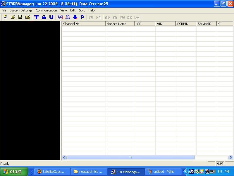

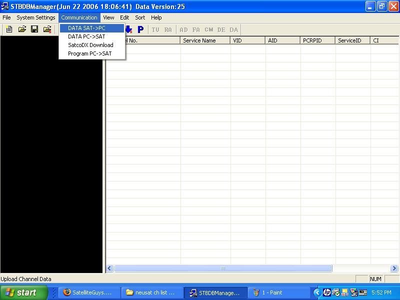

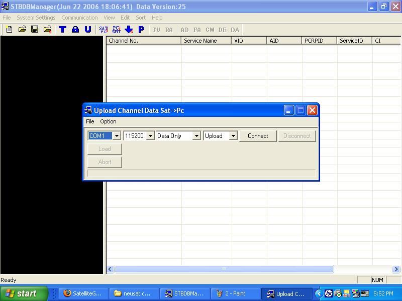

I'll do screen shots (null modem was already hooked up to box)
1. Opened channel editor from Neusat
2. went to communication then data sat -> pc
3. I left everything as is on this screen and hit connect (turn the receiver off and on with the switch in the back and the unit starts uploading)

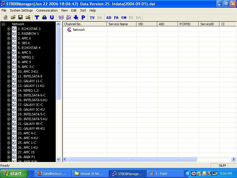

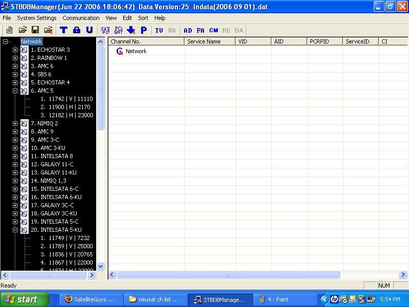

4. This is what I got (transponder list but no channels) :(

Iceberg,
I got the same results and I don't have my Neusat yet.... just open the Neusat channel editor and select file--->new and my results were the same as yours. Maybe the editor is no good.

Step 3! OK. Now I know how to start the upload/download. I was hitting the "load" button on the loader itself. Didn't do anything.
I'm going to try uploading each of those items from the loader's dropdown list to the PC in separate files. Then, I'll try opening them one-by-one with the channel editor. Maybe I'll hit gold at some point.
