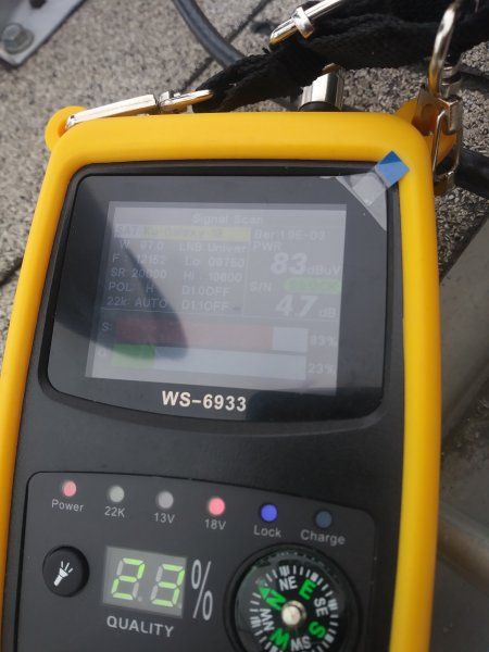

Thx for all y'all help finally got a signal but it blinking in and out don't know what to do next 23% quality
Reactions: FTA4PA
Yes, you are close now. Adjust the dish left and right ever so slightly for best signal. Then slightly move the elevation(up and down) ever so gently for best signal. Once you have done that make sure your LNBF skew is correct. Rotate the LNBF in the holder back and forth and peak it out. Also if possible move it forward and backward in the holder to see if you can improve things. If that don't get you a higher Quality signal after all of that...

You are close enough now you will just have to be patient and mess with things to see what is going on. :)
Also it's a good idea to mark everything (azimuth on pole, elevation on dish and lnb skew) before tweaking the dish for better signal. It's very easy to untighen something and have it move further than you expected. If it's marked you can return to the spot you got a signal. Don't want to take the chance of losing it once you found it! :eek::D
