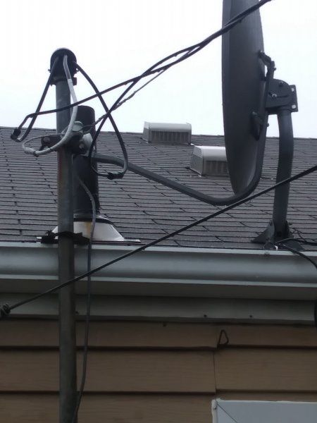

Flip it upside down interesting
I had a dish upside down you take the offset angle of the dish add the satellite elevation angle like 40 degrees. When you add both of them together you get the angle you need. 97w is at 40 degrees elevation for me so I add the dish angle with it.

Wow that dish looks close to the power line! :flame
I saw that too. I believe I'd move that baby to the other side of the power line, like 5 or 6 feet away from it. I can imagine all sorts of electrical interference, like transformer noise entering the system if there's a leak in the shielding on the cable. At least if it's behind the dish, it could act like a shield if the dish is properly grounded. DirecTV would have had a cow if they saw an installation like that when we were installing them.
Primestar actually came around and inspected installations when we were installing them and made the dealer correct the problem when they found one. :)
I bet that was an odd looking duck. :) Never even thought of trying that. Good one.
Lol all I did was put the dish on the mount. That mount was actually set up by directv I actually just took the directv dish down and put mines on top

Didn't know power lines caused interference
Sorry, I went to bed early last night.:sleepy I see KE4EST already gave you a great answer! I have both KU and C but if I had to choose it would be C band. I also live out in the country and can pretty much set up any size or number of dishes I want in my yard (no town or HOA rules :D). I will throw the option of mini-buds (undersized c band dishes) out there. If you search the site there are a multitude of posts regarding them and their performance. Basically, you set up a dish smaller than the recommended minimum size to pull in the strongest C band transponders. You won't get all that is actually available but you usually get something. Many do this because of size/space requirements (again think town/HOA rules) while others do it as a challenge just to see what they can get on a smaller than normal dish. I would only recommend it if it's your only option for trying C band otherwise go with the biggest dish you can find/afford and you will be happy! :)
I didn't know power lines caused interference
