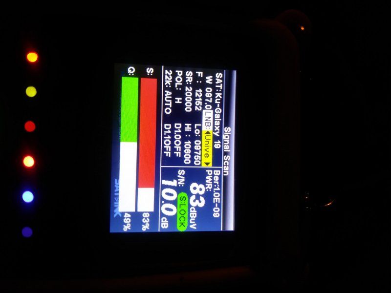

I have a question if I move the Dish from the roof of the house and put it on lets say the roof of the garage would I need to place the dish in a particular spot or can I place it anywhere
If you want to try a larger dish here is one that is highly recommended on Satellite Guys. It includes a pll lnbf and shipping is free. :)
36 Inch 90 cm Free To Air FTA Satellite Dish & HD LNBF | eBay
Thx lol I was actually looking at that dish earlier. I think my problem is the size of my dish its 30 inches like I said I moved the dish and getting the same signal quality 23% its away from the power lines and the only thing in the line of sight is a telephone pole that's like 20 feet away
Reactions: Titanium
You will find that signal quality will vary between different brands of receivers. Having said that, you still should have a higher signal. High 60's to mid 70's is the norm. for a great signal. Some receivers higher. They are not made to conform to a standard, so that is the reason. That may be as high as you can get with your smaller dish. What you need to do now is perform a BLIND SCAN not a TP scan, you should see many more than 18 channels. :)
So should I get a better quality lnb
Did a blind scan its giving me like 18 channels and 2 radio stations
