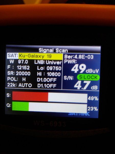

So far this is the highest the signal will go even with all the adjustments

Almost seemed to me from your photo of the dish-roof that the dish may be pointed near, partially blocked by, the roof ridge.
I agree with that it could be but not by my roof ridge could be the neighbors her house sits a lil higher than mines
You're using an offset dish,the signal is coming in from a much higher angle than what the dish seems to be pointed at.
The signal bounces off the dish and down to the lnbf.The vent pipe may not be blocking anything but in any case the dish is way too close to the wires.

An offset dish has the feedhorn/lnb located down and out of the way of the face of the dish so as not to block any signal from reaching the dish.The signal comes in at a higher angle and bounces down to the feed.The usual arrangement for "small" ku dishes.
A prime focus dish has the feed located dead center to the face of the dish.The signal comes straight in and is reflected up to the feed.The usual arrangement for "large" c band dishes.
