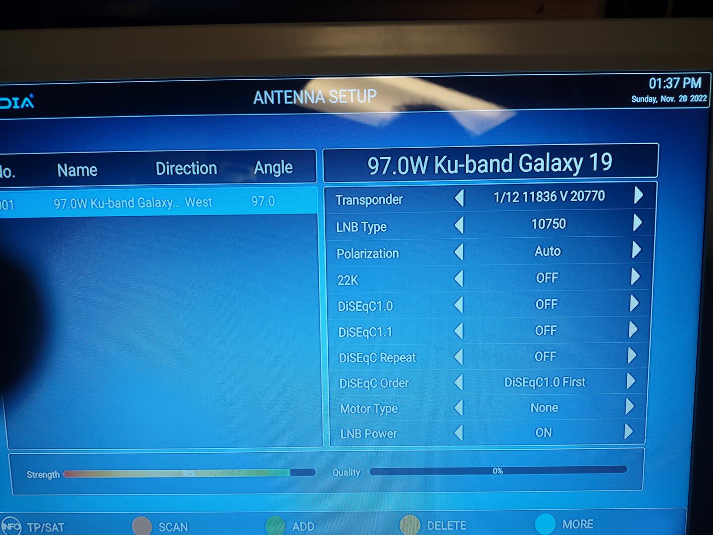

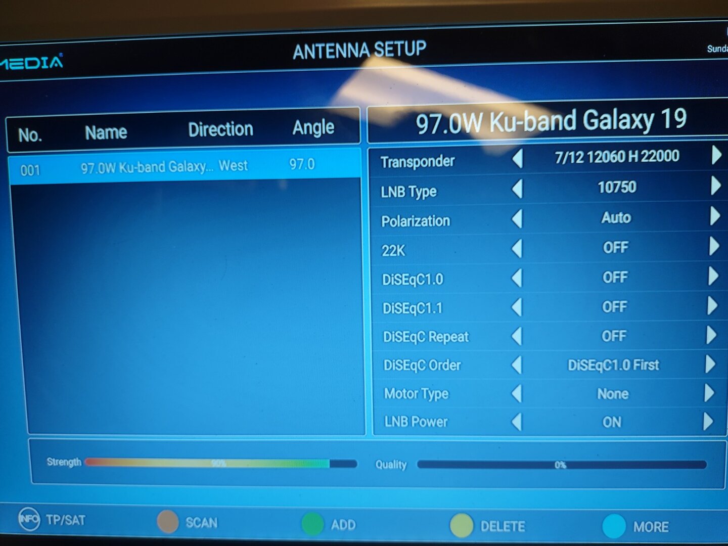

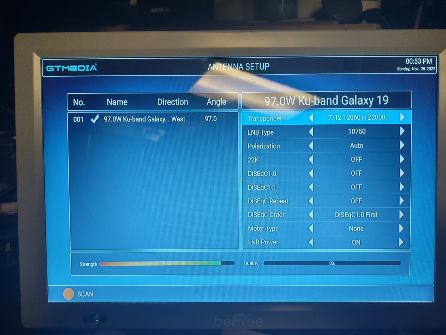

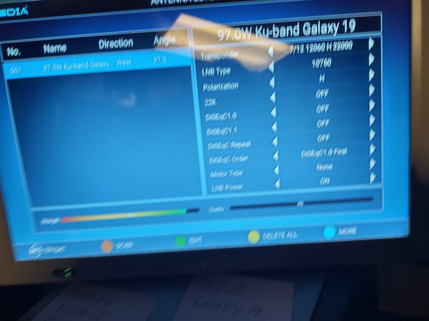

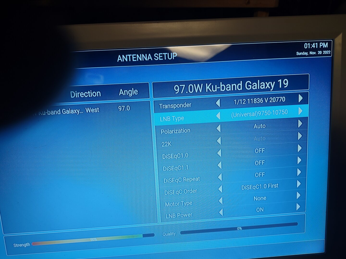

One says universal and the other does not as in pics? Are you saying I should have on the one named universal??
here is both.

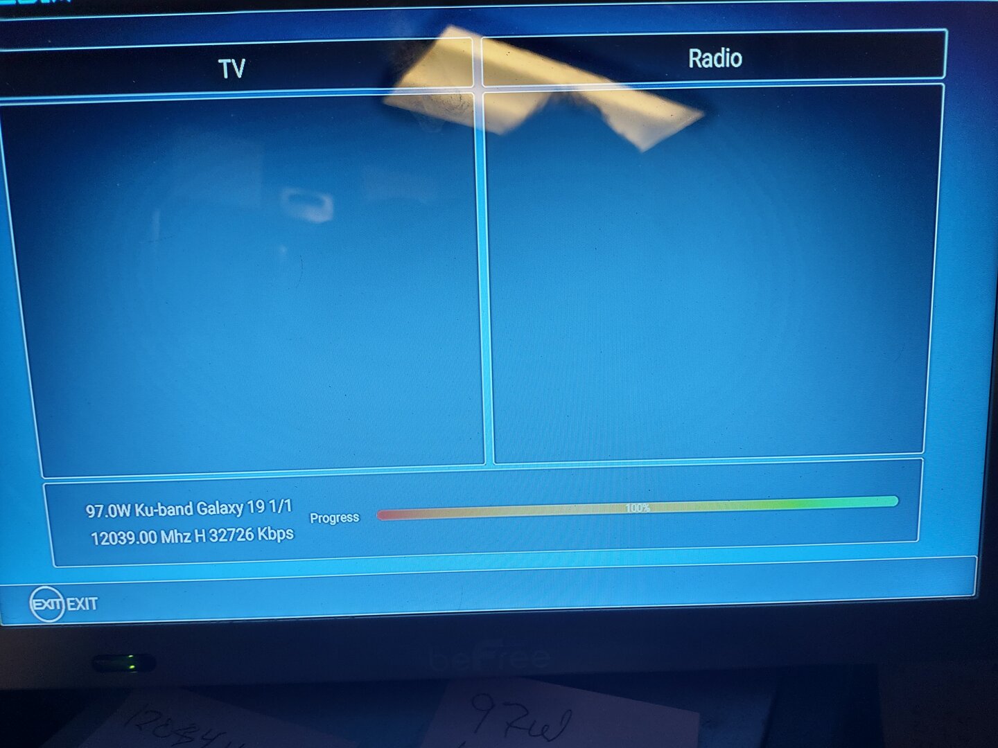

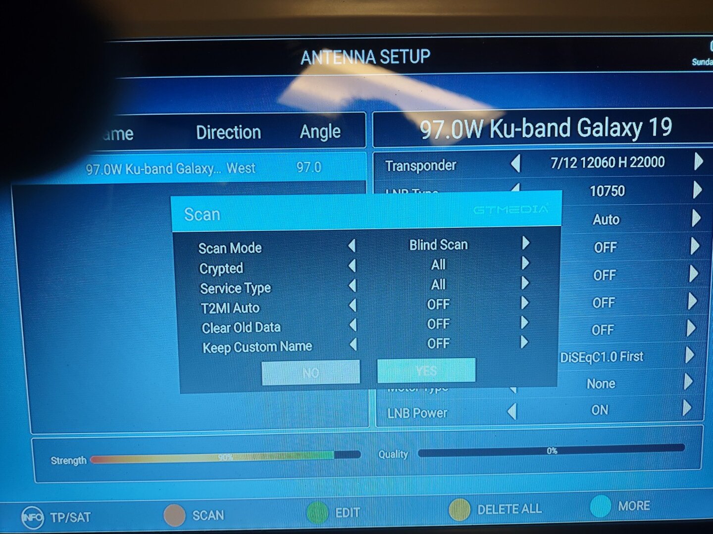

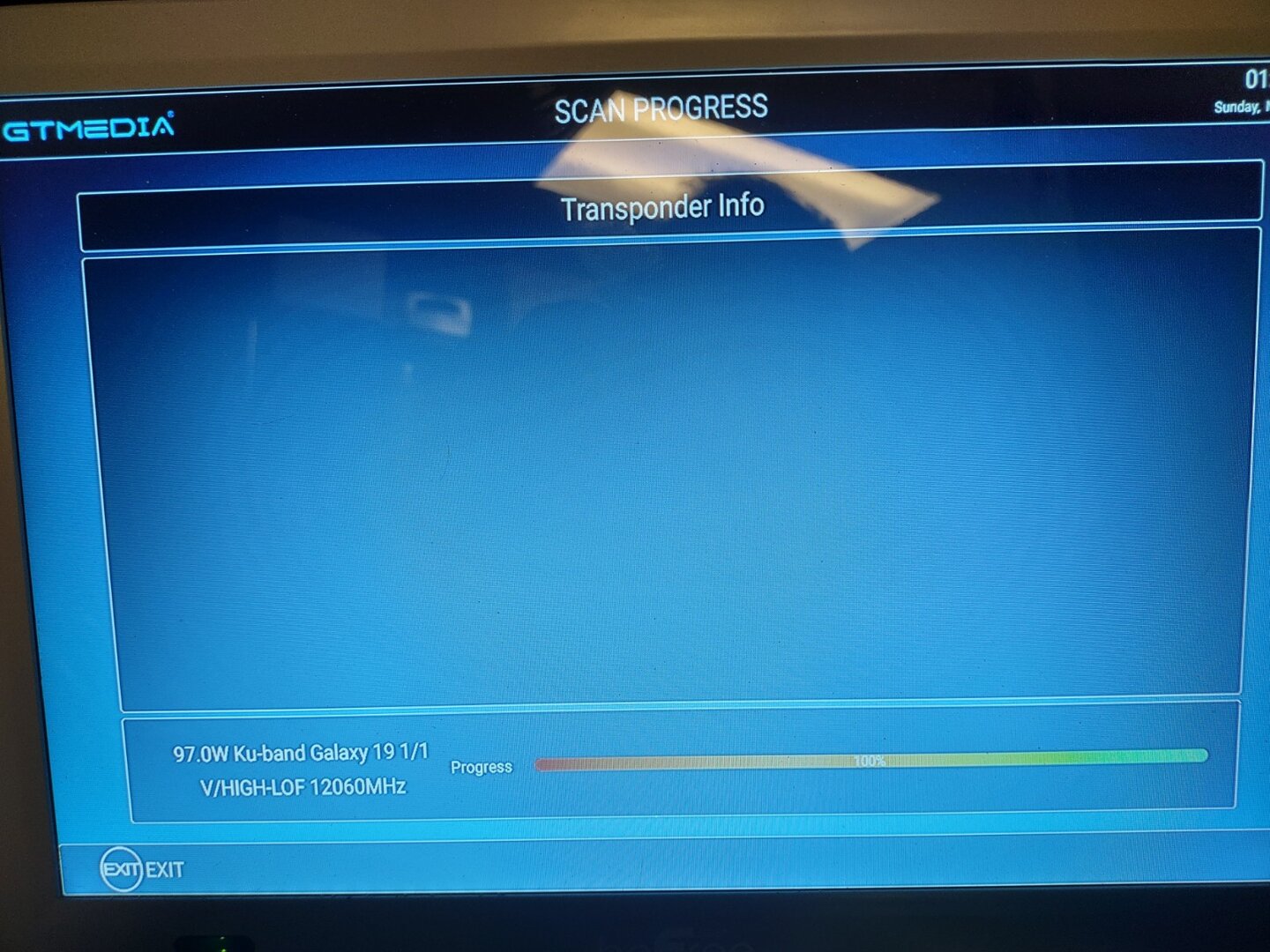

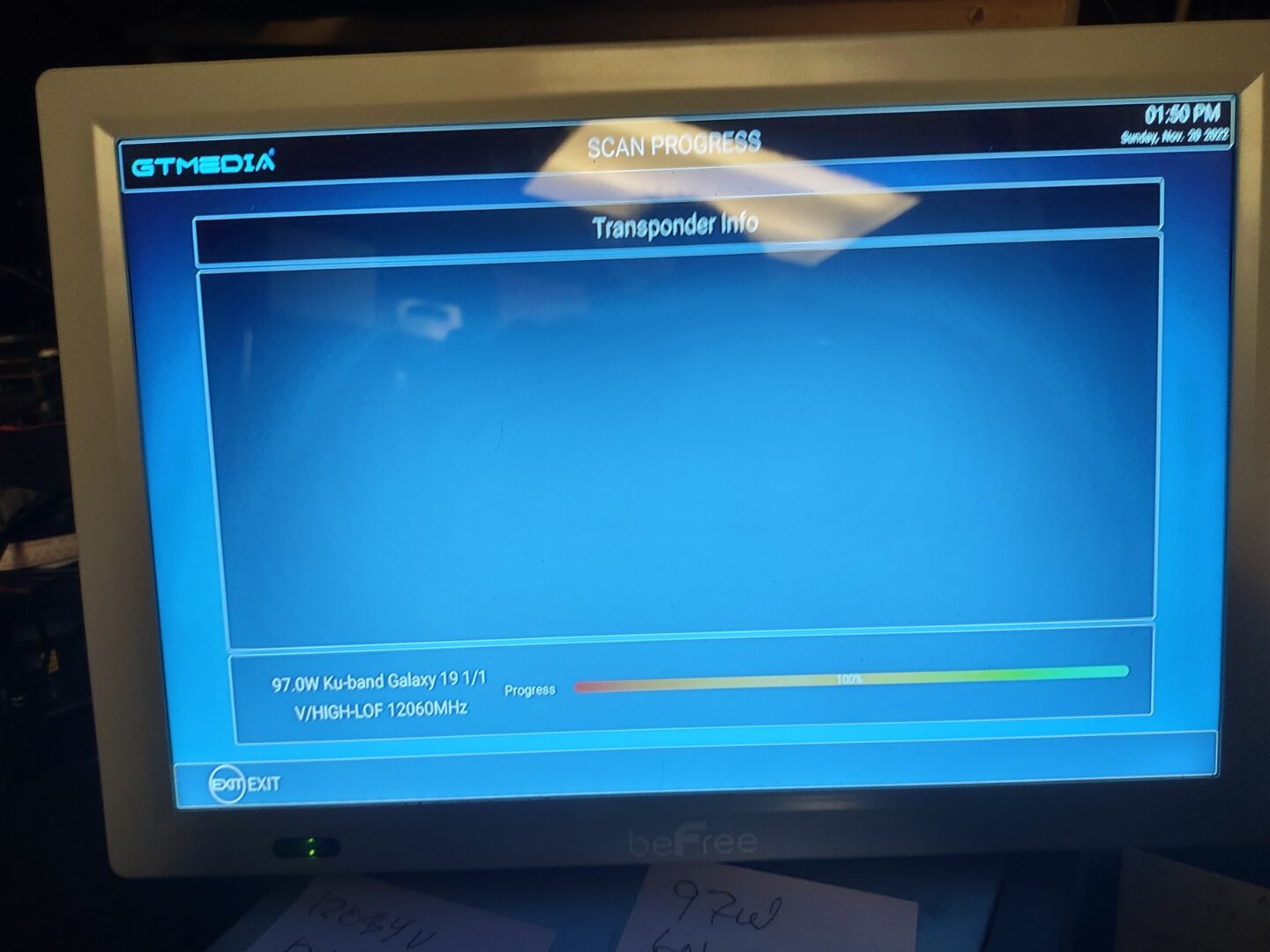

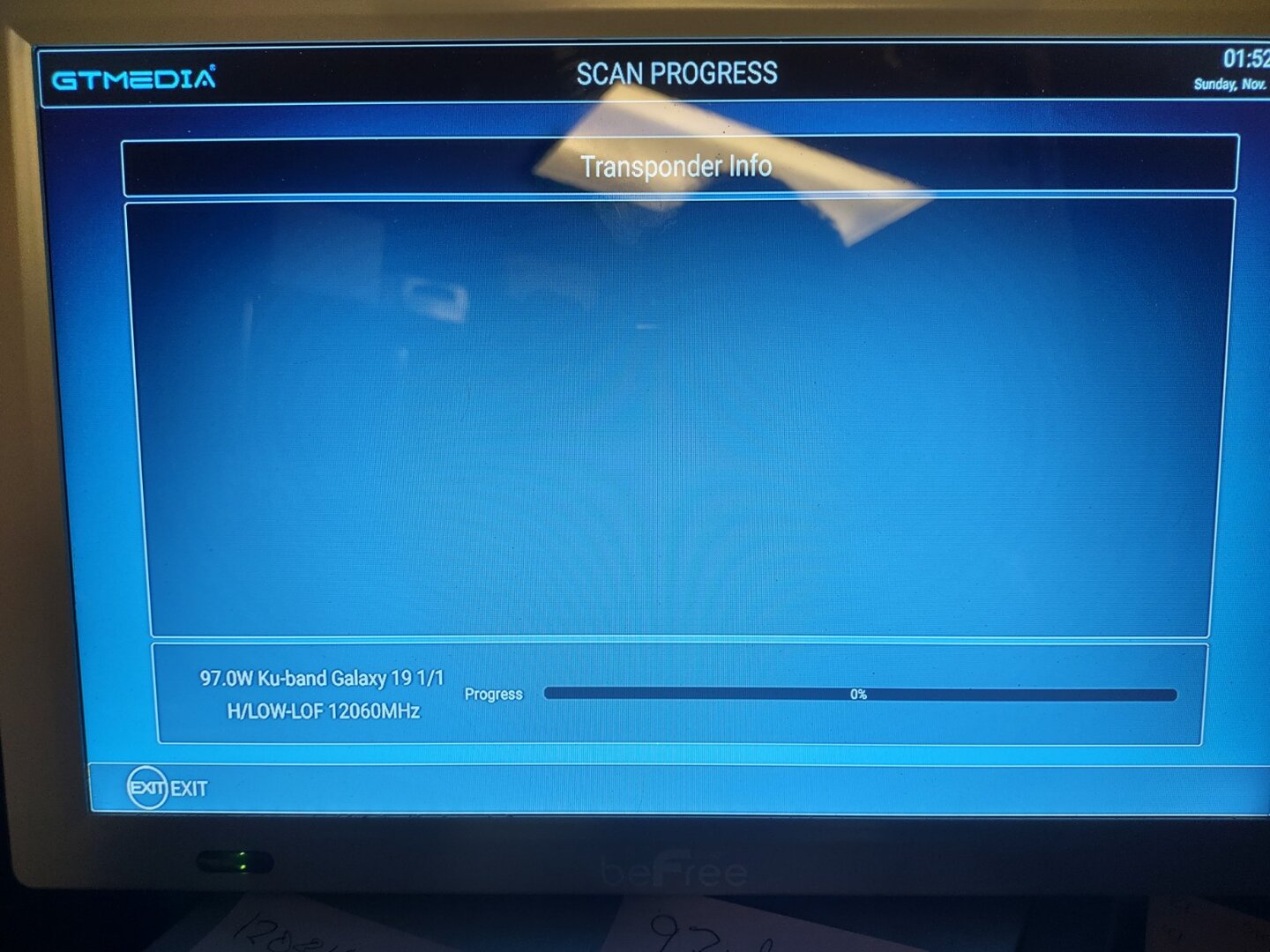

This is the process so I will move dish and repeat till I hit one.

Change Polarization from AUTO to H (Horizontal). Move the dish slightly East or West, and try to get the QUALITY line to get something on it for 12060. With no QUALITY, you aren't getting anything.
Or just keep Blind scanning, then move a hair, etc. After each move, wait at least 20 seconds or so. It needs time to decode, if it hits anything.

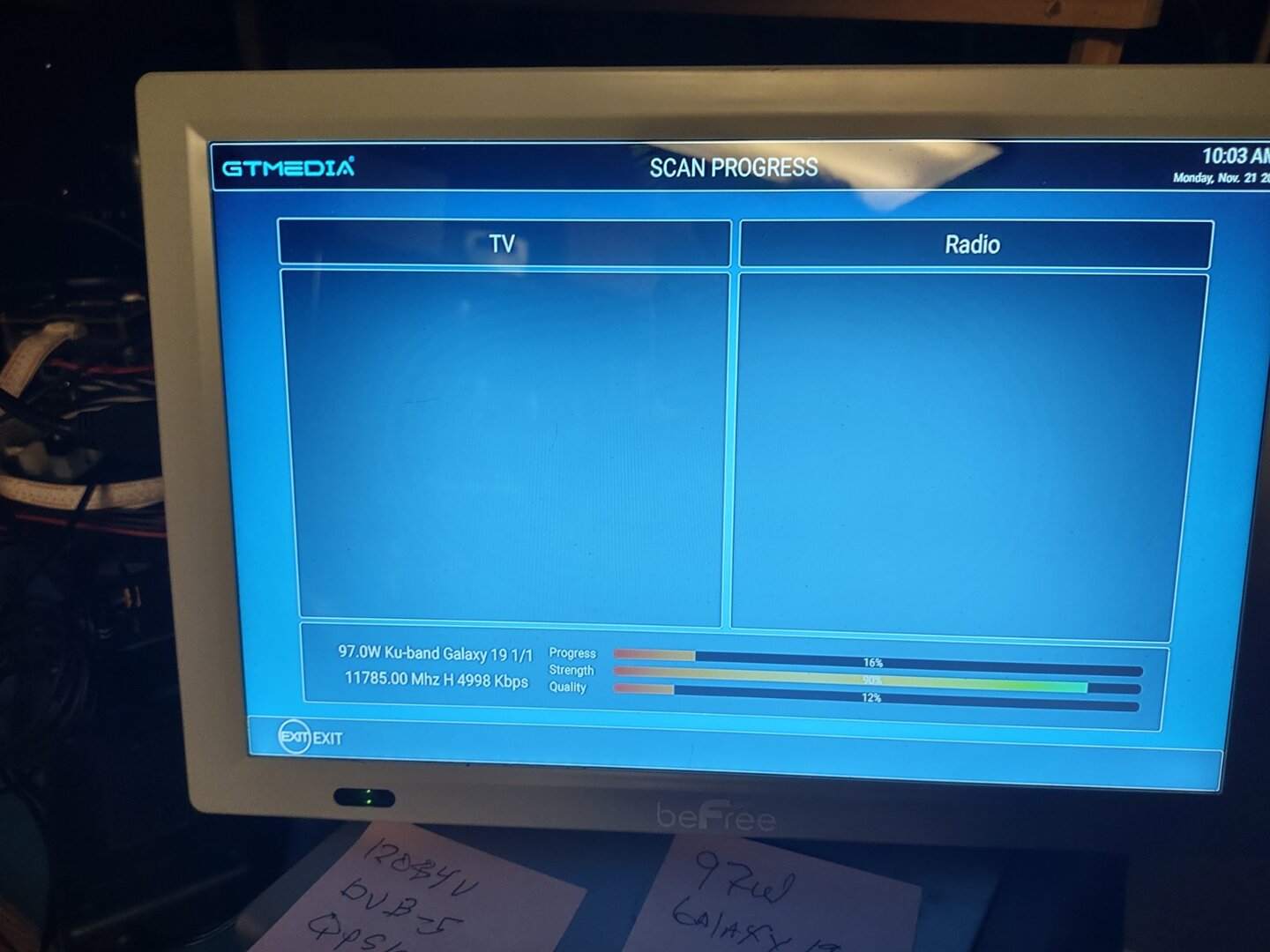

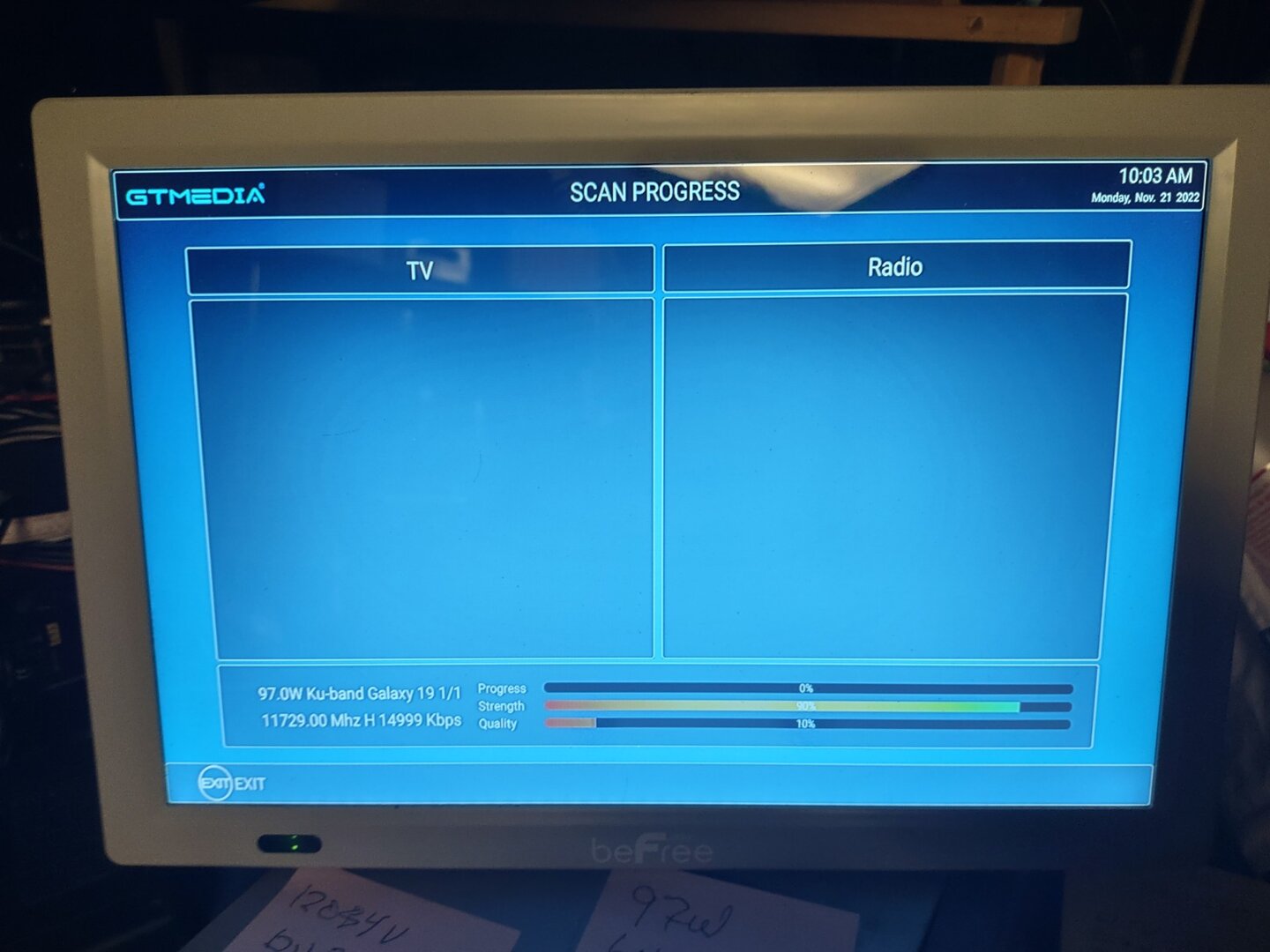

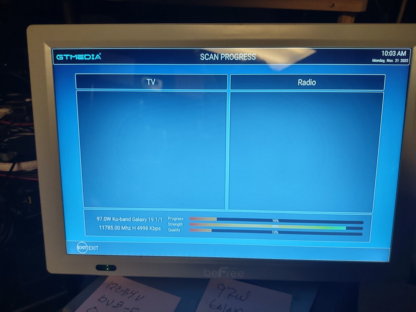

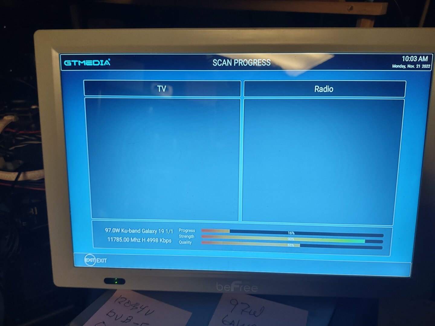

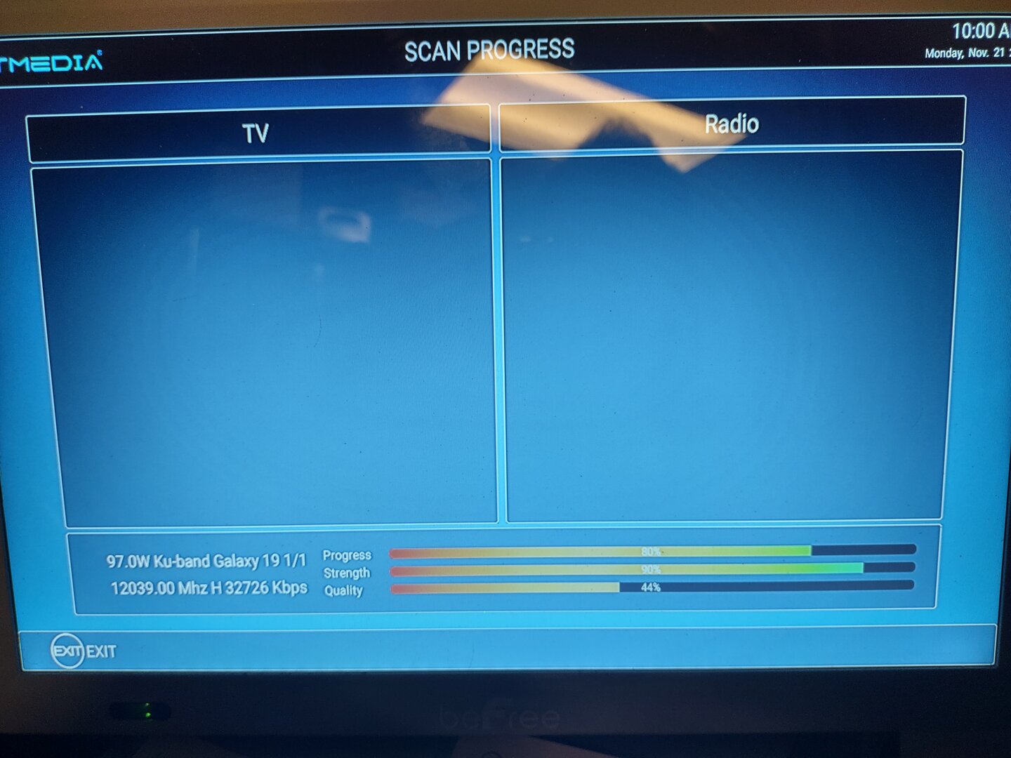

It was part of a dish package but will do also I think I'm getting close...some channel's pop up during the scan then disappear. see pic's.
