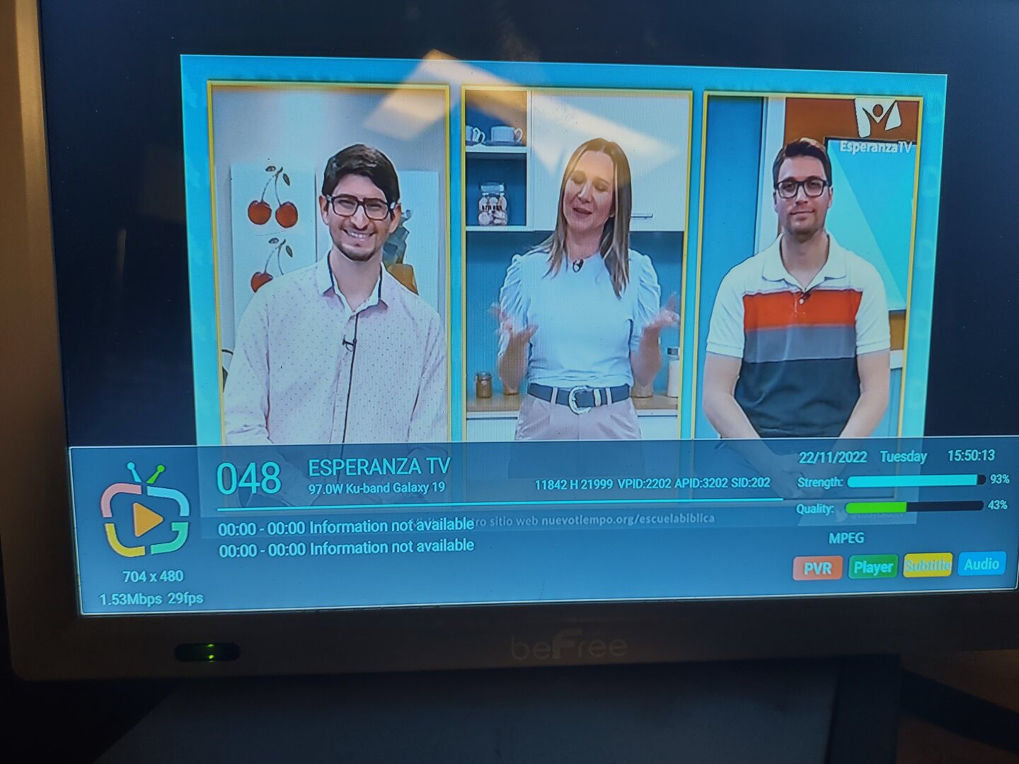

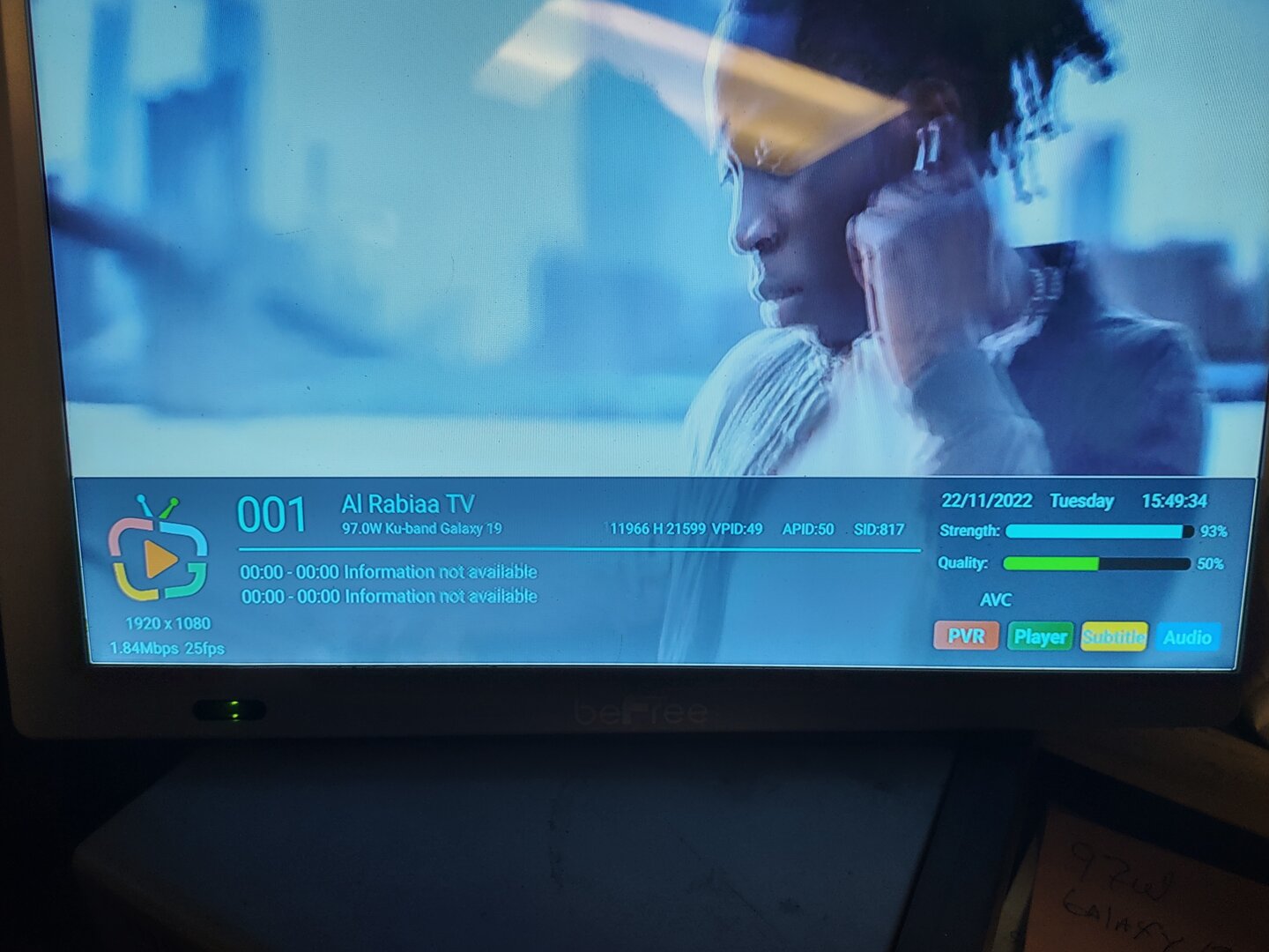

Post another pic of some of the specs on the channels you've picked up.

LOL! I will... ok give me a sec for the channels.
OK, first and last channel...
Ok, that is for SURE 97W. They are on the proper orientation (Horizontal) and proper frequencies.
Try to pick up something on Vertical. Make SURE you are scanning both H and V.
p.s. You've now PROVED that your equipment works. The rest, is just peaking. Though peaking the signals can be a real bitch also, at LEAST you now have something of a baseline to peak against. Get your weakest channel right NOW, and try to get that one UP on quality a little better.
