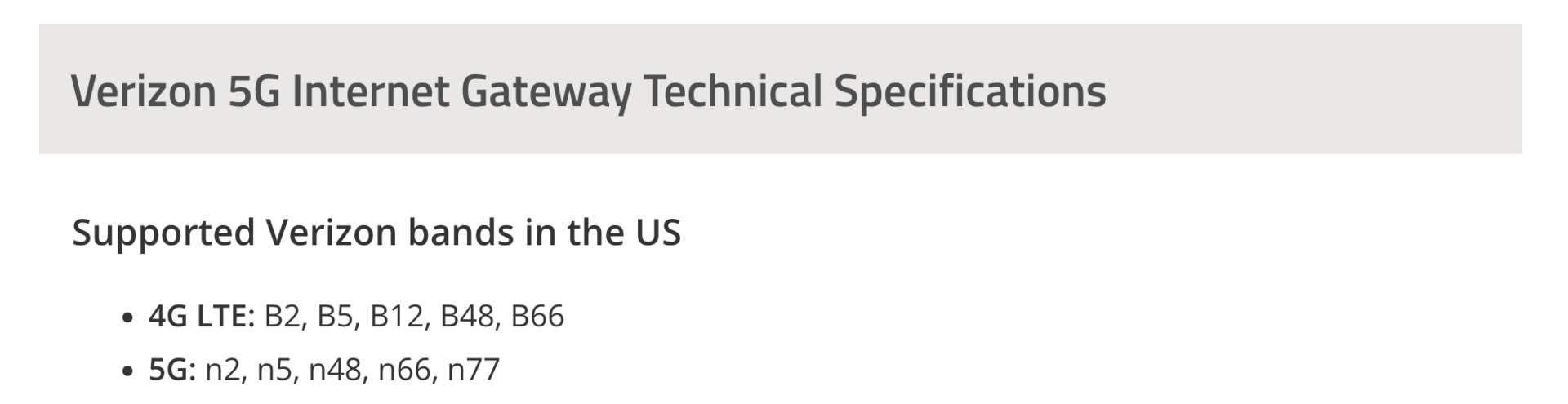

That's just the problem for SOME people. Because they also have these small-cell 5g repeater base stations mounted right on neighborhood power poles in some areas, and increasing more and more.
Or there could be a 5G Internet Gateway installed at a neighbor's house. Verizon's Internet Gateway uses band n77 (C Band) and others.
