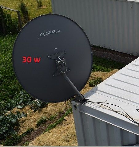

Wow, had 40-60 mph gusts. That was a true test. Everything but 30w remained rock solid through the storm. Kinda makes sense as the 30w dish is a 1.2meter and hangs way out there. I decided to brave the 20 degree weather and check it out. Turns out all it did was rotate on the poll a little but, i twisted it back and rock solid again. We had strong north winds and it made sense that it turned it the way it did. I used my sathero 200HD to peak it. Love this little jewel.
Next summer ill tighten that and/or weld it.
Here is a picture of the dish that rotated to the right and my meter. A normal 12.7 signal was at 4db.

Instead of bolting or welding, place a few strips of non slip tread tape on the bracket then retighten. The grip tape will prevent slipping, but allow adjusting if you wish to aim at a new satellite.
Also, that is a pretty large dish hanging on a 1 5/8" J-post that is designed to be used with support legs. Would be better to weld a 2 1/2" thick wall vertical pipe on a flat plate.
Yes, i agree. It is the only dish i have on that container that doesn't have a secondary support of some kind. What is non slip tread tape? Like a teflon tape?
and this thread tape will not have an issue with the EXTREME cold we get here. Being one side is adhesive, I've come to find very few adhesives work outside when we get into the single and negative degrees.

1) I am going to downgrade my 30w from 1.2m to 90cm.

  • I am currently trying to catch 30w on my 90 cm, but thus far not getting it.
