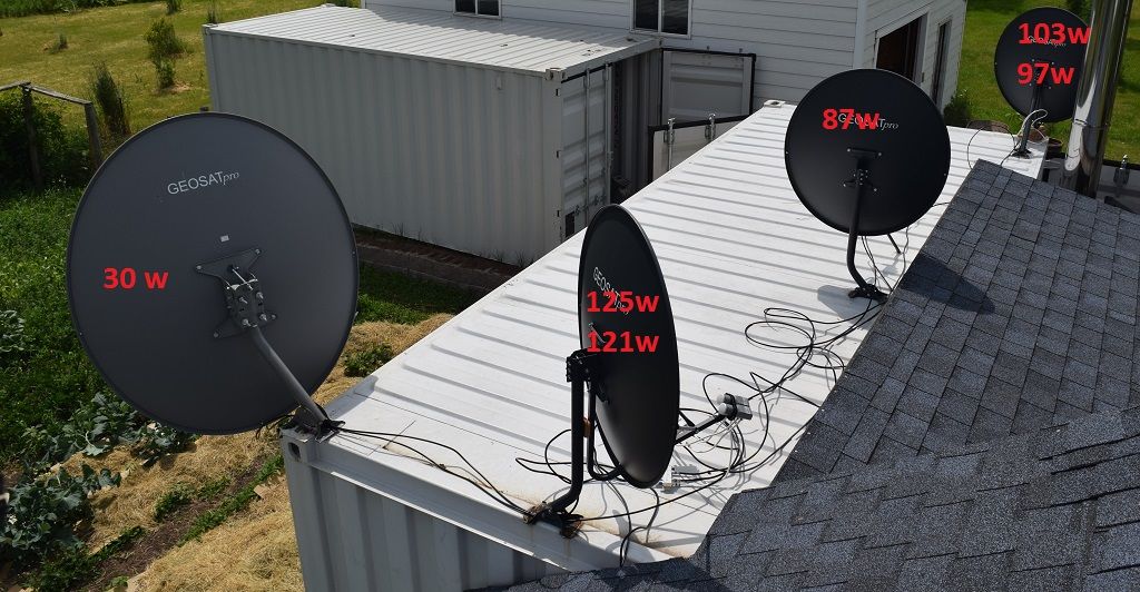

My dish farm now consists of 8 total satellite antennas. 3 cband (8', 10', 12') , 5 KU dishes. (3',3',3',4',4')
I now have FIXED locks on :
  • 30w KU
  • 87w KU
  • 95w KU
  • 97w KU
  • 101w Cband
  • 103w KU
  • 118w KU
  • 121w KU
  • 125w KU
This gives a wonderful variety of channels for my 4 rooms restricted to fixed dishes. It also makes it very easy for family visiting as they can channel surf all the channels just like OTA tv.
